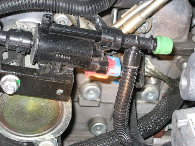

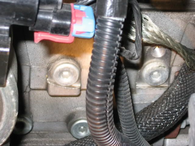

i just went out and took two quick pics.
are you talking about the one in the upper right corner ? on the driver's side on the head.
cool just in time im going to be installing one this weekend
thanks,james
Patrick Myers wrote:top of the head there is 2 plugs with a hex head in the center. remove the one in the back closet to the firewall and install your line to that. run from there to your sender and your good. it'll run 100 psi til it warms up then it will go down slowly to about 25-35
