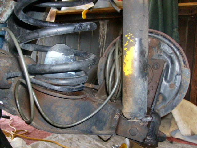

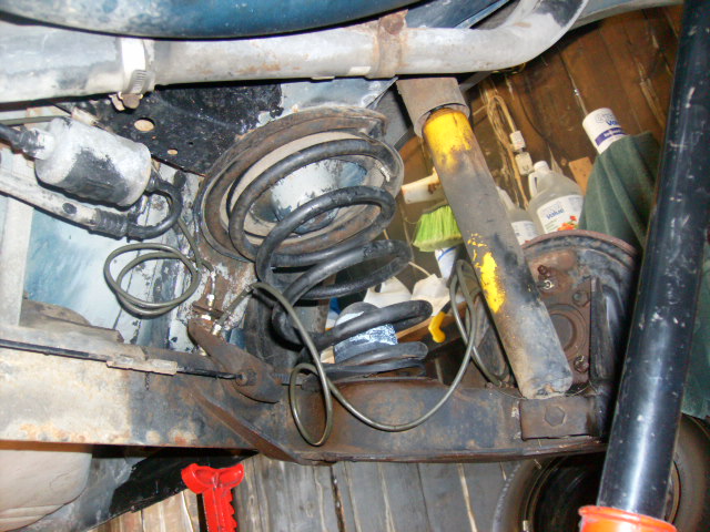

Rear Suspension
Spring Detail
Not real bad shape for a 26 Year old Michigan Car
Trying to find the stabilzer bar bushings and both the upper and lower spring isolators.

Couldn't help but notice your fresh brake lines and cables in the first pict. Looks real nice!! :-) A lot better than my "country boy special" :-O
I'm not an expert with brake/gas lines.....At least it worked, and it passed inspection.

Orlen-
Thanks for the compliments. The SS brake hoses work great. I had to replace that line with the leaking wheel cylinder a couple of years ago.
Hey, you got it done and quick on the draw with the pic too

You need to rebuild your spring perches!I used quick steel to make mine.Sand down clean,kneed the product and make a nice ball and use your existing boot to mold it exact.I reused my lower rubber boot,and upper rubber and metal ring!SO no new parts on those.I was so thinking hard on that today and realized what the heck you meant.I was wore down,not focused.let me throw some rear end pics or two up.Yeah next post.As stated advance had TRW springs back in 03 or 04 can't recall.Could not find my old post so.let me get a pic of so from my cardomain.Your perches are worse than both mine were.

I started sanding the back suspension in preparation for the por15. Ron, you thought the passenger perch was bad... The driver side one is completely flat
The shocks and mounts look great, I have to get the spring isolators next.

I sanded things down and used the quicksteel on the passenger side perch, as well as fabricating a driver side perch with a washer and some quicksteel. When I bought it from Orielly, they were all out except for their carded quicksteel. Apparently somebody from Chrysler/Fiat came in and bought all of their stock up to deal with an issue with the Fiat 500. The Chrysler plant that builds the 200's is right down the street for me so there is a lot of MOPAR activity in there area. Detroit area has Ford, GM, and Chrysler Fiat, but everyone already knows that
At any rate, will be getting one more tube of quicksteel to finish things up. So far looks like a good product and nobody is going to see the repair once the isolators are back over it. The product is pretty good to work with but does not stick to your hands like POR15 does - Thank GOD!

Would really like to see some before & after picts of those perches. If I ever run into this I'd know what is lookin' back at me!! :-)

You have the befores I will post the after quick steel and after painting pics

I'd bet most perches are toast or close to it like mine were yrs ago before I did my resto work to fix.Rubber over metal and not sealed it will rust out just due to moisture.Nice share paul.

ok, finally got around to taking some pics and doing some work...
These are after quick steel and before POR15. I did not want to touch my camera after opening the POR15, it has a way of geting on everything. I will take some and post after it dries. Nasty stuff.

POR15 first cote:
Will have to do it again once the springs and shochs are back on...

Notice how it ate through the styrofoam cup in the lower picture...
