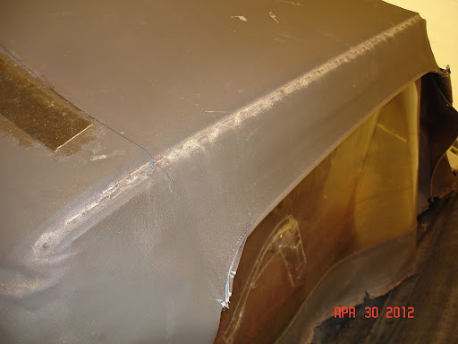

Amateur top replacement and it really was not that hard. I think that anyone on this site could handle it. I got a video from ebay that gave me step by step instructions for the 2nd gen Cavalier and it was well worth it. Just took my time and worked on it a total of about 16 hours. I repainted all the exposed top frames and used the old pads and rear window zipper ( If you replace the pads make up some wooden braces and screw them to the bows to keep the bows in the exact same place when replacing the pads). I did get a used Bea air powered upholstery stapler, but I think you could probably do it with a hand powered one. This is top number one and plan on doing the blue one later this summer. It was good practice for the blue one and I learned a lot. If you do it yourself just be careful when removing the old weatherstripping as mine was glued on with silicone in some places. I could have reused it, but I located a set of second gen (94) convertible top weatherstripping from a local salvage yard for $20.00. It is not perfect but hey neither is the rest of the car. Plus the next one won't have the same defects as the first one.

Paul if you do, GET the how to video from this guy. link = . http://www.ebay.com/itm/Cavalier-Sunbird-Convertible-Top-And-Vinyl-Window-88-91-/130690876950?pt=Motors_Car_Truck_Parts_Accessories&fits=Year%3A1988%7CModel%3ACavalier&hash=item1e6dc88 616&vxp=mtr . He used to have the video for sale separately and he only has the video for gen 2. The only thing I would do differently is put the belt molding on and scribe marks with a pen all the way around the top and then remove the moldings and trim the excess. As you can see in the 5th picture down my trim was not exactly neat and I had to remove the molding to re cut the excess anyway.

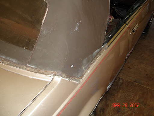

Great job on the top! I'll bet it makes all the difference up close...and when it rains! How hard was it to pop off the trim on the sides (with the button snaps)? Did you have to remove that to 'tuck' the top underneath?

Those have to come off so the top can be stapled to the tack strip. There are about 10 9mm nuts inside trunk and 2 more that are accessible from inside the car with the well liner lifted up.

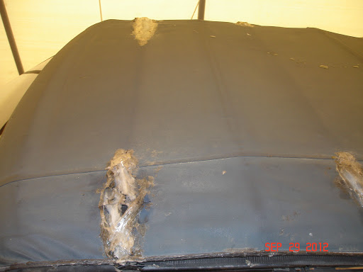

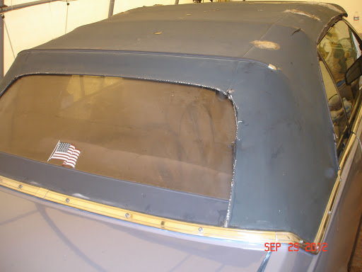

Top number two completed this weekend. I Finally am not embarrassed to put the top up. It's only been falling apart for about 10 years now.
