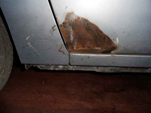

Well, I finally got around to starting work on the Coupe. Done dragged my feet long enough. Got my first gallon of custom mixed X-O Rust from the hardware store last year. Gallon of the stuff cost a paltry $33
Trying to use all the lessons I've learned on this one. Upon taking off the primer on the top section I discovered it was terribly pitted and had been covered up with some Bondo to smooth out the top. At first it broke my heart to see the damage, but after finishing up with my wire wheel I saw that there at least wasn't any holes. After the first day I came to realize this was the perfect car for me after all, haa haa, at least I couldn't do much worse to it.
So here are a few befores and afters. I used the 4" foam rollers and laid down 2 coats of rust inhibitor all over the top and rusted areas. Followed with 2 coats of Primer , then 2 Color Coats. After the 1st Color Coat I took a small brush and tidied up any areas the rollers couldn't get to, then tied everything in with the second Roller application. Professional it ain't near to. Much better it definitely is. The Custom color mixed Gallon I got is very thick and lays down a very thick coat. I won't be worrying about rust issues around these areas for a mighty long time - that was the goal.
Went today and picked up my Custom Mixed Gallon of Dark Blue to 2 Tone the car with. Picked it up on sale at the hardware store today with a 25% Discount Coupon - so this Bucket of Paint only cost me $25 today. I'll take it to my local Napa and have them add some metal flake to it , mix it up, and pour it into 4 quart cans to make it easier to work with.Ran across a Quart of Dark Red that was a Return while I was there for just $3 that I'm planning on using to Stripe and trim a little with.
I'll have to get a couple of photos to show, but I found I can take a used quart oil container and cut it from bottom to top- just after the neck. This makes a perfect container to pour my paint in and use the 4" roller out of. When I'm finished, I just pour what is left back in the can and toss the oil container in the trash.
So my great investment here is about $60 for 2 gallons and 1 quart of paint, plus a few paint brushes and some 4" rollers. Beats the hell out of 4 Grand , and I don't have to worry about the clear coat drama ever again!!
