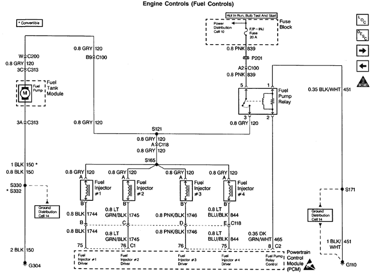

Here's a 97 diagram for reference:

Thanks Dave, I'll go over this and see what I can figure out.

zeroto60in6flat wrote:
hmmm....with most cars a 12v signal is used to open and close the injectors. on GMs, the injectors receive a constant power and the computer sends the ground as the signal.
The diagram seems to support this too, has anyone just hooked up the ground to one of the injector's ground? that might do something, or if not that, hook up the ground, to the power side, and the power to the "signal" i.e. ground from the ecu, and then reverse the polarity, since you'de get a negative voltage that way. -12, so just ,make it a + number, anyone try that?

because of the @!#$ty translations, i would imagin that the injector "ground" wire really goes to the constant power source

I was thinking of connecting balck/red wire to the injector power wire but I don't want to fry my Emanage.

I connected the black/red wire to the constant power source and nothing changed with the duty cycle. I'm at a lost of what to do next, guess I'll just tune with my 440cc injectors and do what Geekd is doing.

on every other car i looked up an emanage install for the red/blck injector ground wire goes to the chassis ground. The emange needs this in order to actually add fuel, this wire is used as the ground for the inectors signal. If you dont have it hooked up, the emanage will tell you its adding to the duty cycle but its really not.

That is where I first ran the wire and still nothing happened, that can't be the problem
