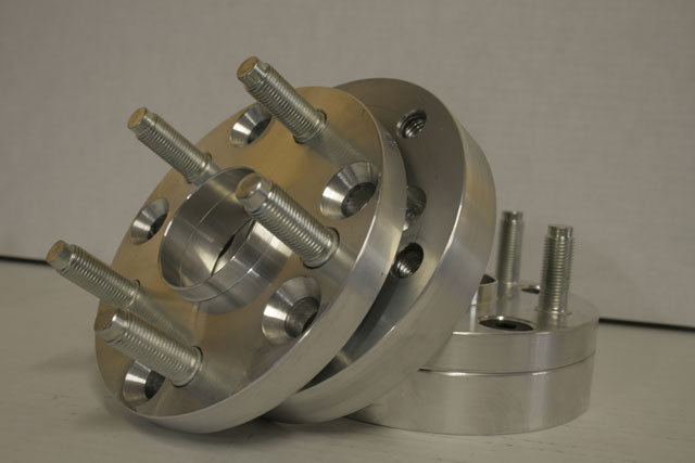

I see your gonna use 4 lug adapters, is that something you can just take on and off when you want to put some street 5 lug rims on?

The adaptors are just bolt on/off, they look like this (these aren't the exact ones tho).
Inner piece bolts to the hub, the outer piece bolts to the inner piece and the wheel bolts to the outer piece.
Sounds kinda sketchy, but the guy assures me they have run this set-up on 900hp Camaros with no issues. They also come with a lifetime unconditional warrenty and $1,000,000 liability insurance.
