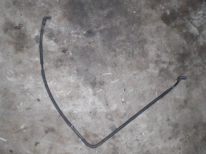

hey john here is the line i found that i forgot i think it goes to the accessory spot on the tb that is empty.
i think the left side goes here on the tb but i do not have any idea where the other end goes. any help would be awesome thanks john

That go to a little black like bos by the AC compressor (has to do with evap). The other end does go to the TB spot in the picture. That should fix the idle, now let it run.

i thought the middle vacuum line went to the evap can??? so where does the middle vacuum line that is connected to the tb in the picture go?

middle one(big) goes to the brake booster.
other small one goes to firewall then to the hvac controls.

yea the yellow circle is the brake booster the red circle is to the evap can by the ac compressor right and then the one with the arrow goes to the firewall for the hvac controls? where at on the firewall. but if that last vacuum line just goes to the firewall for the hvac controls that would not effect my idle would it?

Ok the hose you posted the picture of this one:
Is for the EVAP. The hose for the HVAC is a smaller hose like the one for the FPR. The one for the HVAC goes on the empty nipple in the other picture. The EVAP goes to the left of the brake booster and the FPR to the left of that one.

right i got all that but where goes the hvac one plug into on the other end i cant find it on the firewall. also do you have any more ideas on the high idle, like i said it is up to 4500 now and i never touched anything. all i did was leave it over night and went out and started it up this morning.

The HVAC hose goes into the engine harness right by the starter. If you can't find it cap the nipple on the TB so it does not suck air. Until you have that vaccum leak fixed no need to worry about high idle.
