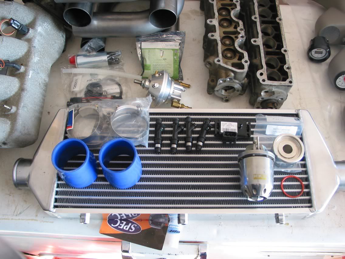

So I am building a 2.4 block for a really nice turbo setup. I have recieved my
1)wiseco piston kit
2)eagle rods
3)cometic NA Head gasket (to raise compression to hopefully 9.2:1ish)
4)2.3 oil pump/pickup/windage tray
5)clevite 77 main and rod bearings
6)turbo, etc, etc
so I pretty much have everything I need including Fuel management and stuff, so my question is this.

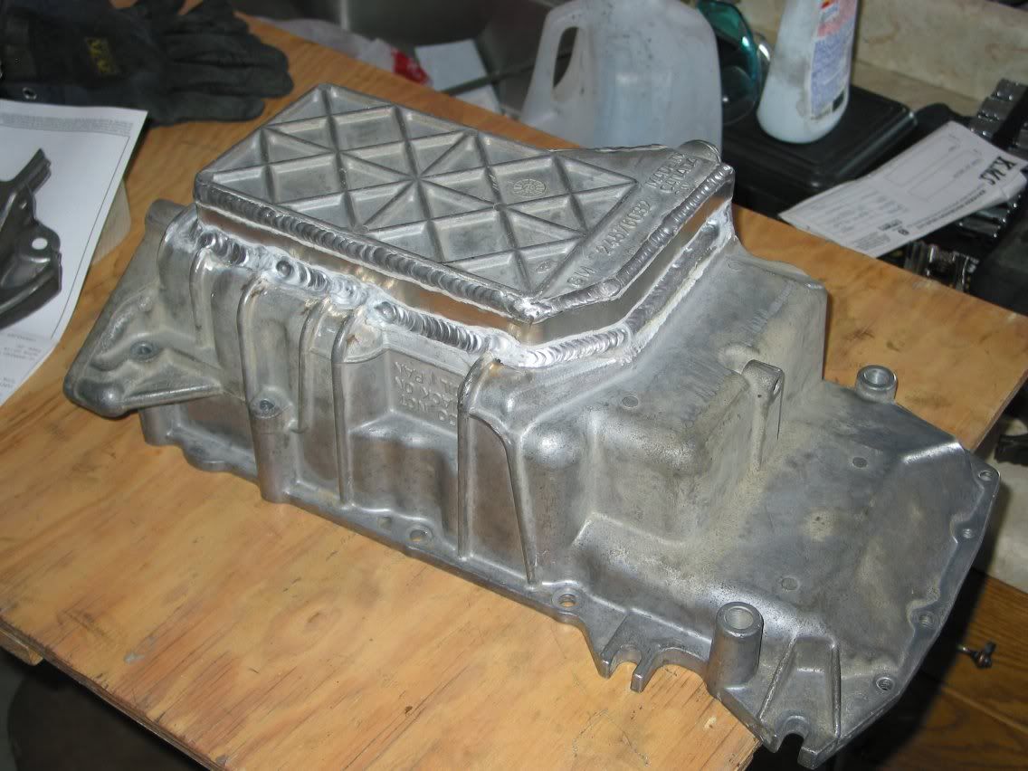

I modified my oil pan and drilled/welded my block, all I
am waiting on is ARP mainstuds from jtuners.com and the bottom end goes together

Oohhhhh, looks very nice. I dun know anything about 2.4's otherwise i'd chime in, but looks like you got a lot of bases covered. What are you using for fuel management? i see what looks like a 2025 cartech FMU there, and some larger injectors.. anything else?

yah, I will be using the GM s/c reflash, so 2 bar map, 310cc (for now) and the begi to raise fuel pressure under boost, once HPTuners comes out I will buy that get 550cc injectors and selling the begi. I should be able to get a decent tune with my wideband, until I can get to a dyno.
