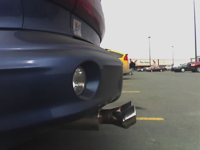

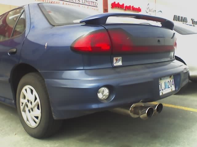

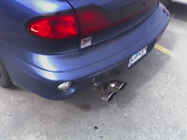

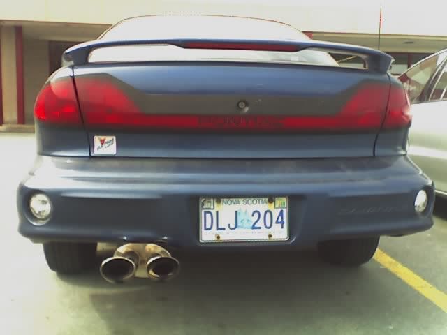

Friday, March 31, 2006 7:52 AM
Sorry for the rough pics???
Good and bad feedback welcome...

you need to rehang it and tuck it under the car, rather than having it stick out like you have it now.

Horrible doesn't quite describe how horrible it looks. Sorry man, I'd definitely rethink that.

If someone would rear end you they'd hit the muffler 15 seconds before they hit your bumper. JK! But yeah it needs to be put under the car more.

I tried to tuck it in as far under the bumper of the car, but the way the tips extended out of the muffler, they kept getting caught on the under lip of the bumper. I can try it again and see if I could get it refit, but I honestly can't see that. I'll look again though.

what we're talking about is depth wise fitment, not necessarily height wise (although that could be changed just a little bit).
what i say is cut the muffler off the pipe, and cut about 3-6 inches off the pipe, and reattach the muffler. the tip would look good if the most outer edge of the tip lines up, or is just a little inside, of the bumper edge. also, move the muffler just a little bit higher if you can, just as long as the tips aren't touching the bumper, and that there is a small gap of air there.

Viper98912 wrote:what we're talking about is depth wise fitment, not necessarily height wise (although that could be changed just a little bit).
Sounds like it would work, but the shape of the muffler compared to the shape of the bumper underneath, might be a little difficult..
I'll give it a try, definately

The the tips were straight out it would have been a better fit.

eh... I think it's just all-together the wrong muffler. Of course, you gotta take that with a grain of salt because I'm VERY partial to single-tip, single-exit exhausts.

Not the right muffler. Maybe if it was tucked up a bit higher and back further under the bumper. At the least, get the outlets to follow the bumper so they don't stand out so much. But that style of tip is better if it's more like the DTM's. Those look okay on our cars if done right.

heh. These probably weren't the responses you were expecting, eh?
I agree with pretty much everyone here. It looks terrible... but shouldn't be hard to fix.
I'd cut the tip off the muffler and move the muffler under the car to where the stock one sits.
Then get a pipe around 6" long or so to go from the muffler to your tip.
Honestly, I'd look into getting another tip as well though. The way that one angles up just won't fit nicely under the bumper. You need one that sticks straight out. You need a bigger cutout to fit a tip like that and you just don't have one.

It's not that it's horrible. And I wouldn't call it gay unless it was dresed in pink cashmere and talked with a lisp. But if you tuck it up further under the car it'll look ten times better. It's all about execution, no matter what the muffler looks like on its own. Part of the problem is the muffler is just sitting too far down. You can see the entore rear face of the main body, which throws off the whole look. Tips like those look better if the body of the muffler is out of sight. WHat I would do is tuck it farther up under the car, with only a minimal gap between the tips and the bumper, and that should do the trick. If not tey blacking out the muffler body with some high-temp paint.

If I tuck the muffler right against the bumper, would it 'melt' the bumper at all. How much gap would I have to leave??
Re: What do you think of my exhaust?
Friday, March 31, 2006 3:55 PM
My HKS Dragger rests right on the bottom of the bumper and I haven't noticed any scorching or melting as of yet but yours has more surface area that can actually come in contact with the bumper. For the most part it won't get hot enough to melt the bumper itself, but it can burn the paint. Leave about a 1/4" gap and you'll be good to go.
