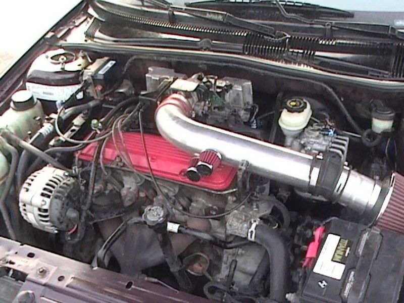

The picture isn't the best, but here's the result after some stuff called "Crud Remover" from Advance Auto. It's made by a company here in Iowa. Works really well and won't damage paint. After I did some engine work my entire engine bay was just horrible. The valve cover was practically black from grease and dirt, the intake looked nasty with greasy finger prints and whatnot, and my firewall were covered in grime to the point the paint barely showed through. Now it looks good as new.
