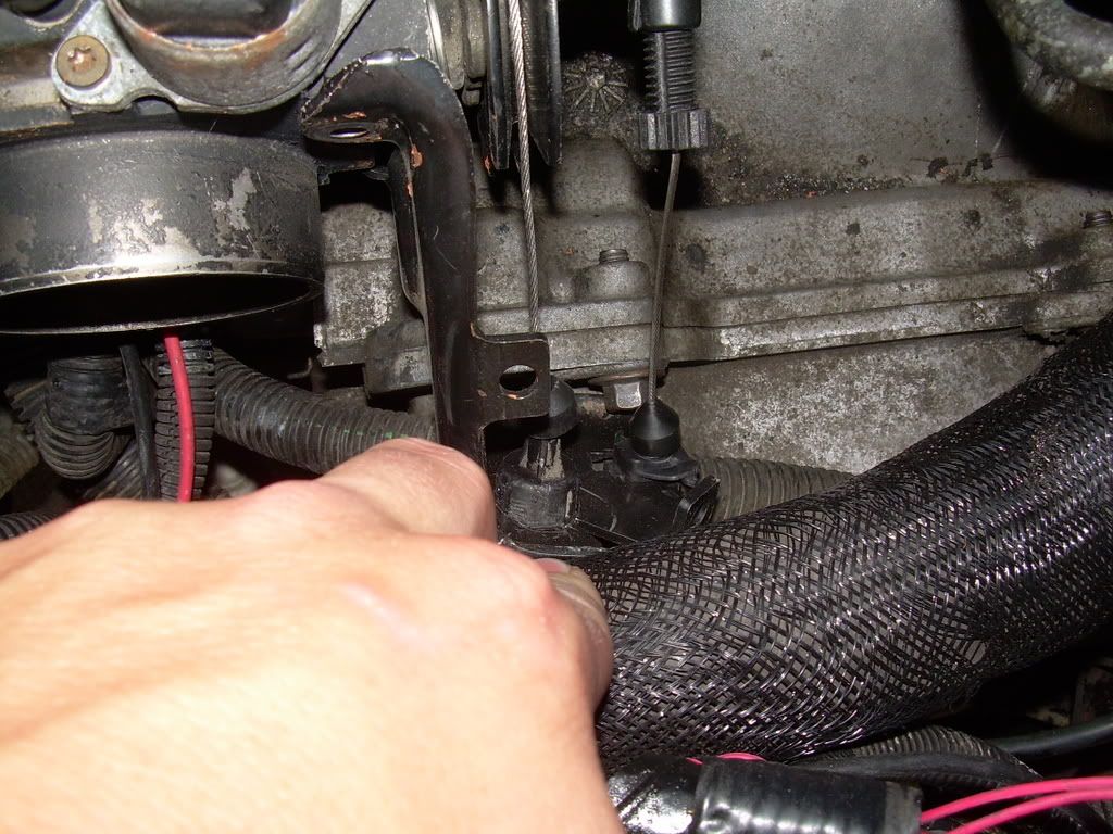

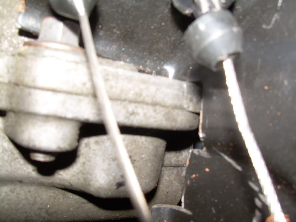

i used a dremel tool and cut mine to where it would fit around and over the transmission bell housing, didnt cut too much out of it, and its still stiff and works good, i have both the throttle cable and cruise control hooked up, the only pictures i have suck but here they are anyways.

thanks for the pic. its really hard to see it but ill take a look at it tomorrow. do you know if that vaccum line that comes fom the a/c has to be hooked up even if i dont have a a/c on my car any more? and will my stock 2.4 iac sensor work on the 2.3 t/b as well?

i tell you what, here in about 30 minutes i will get my butt up and take a much better picture for ya.

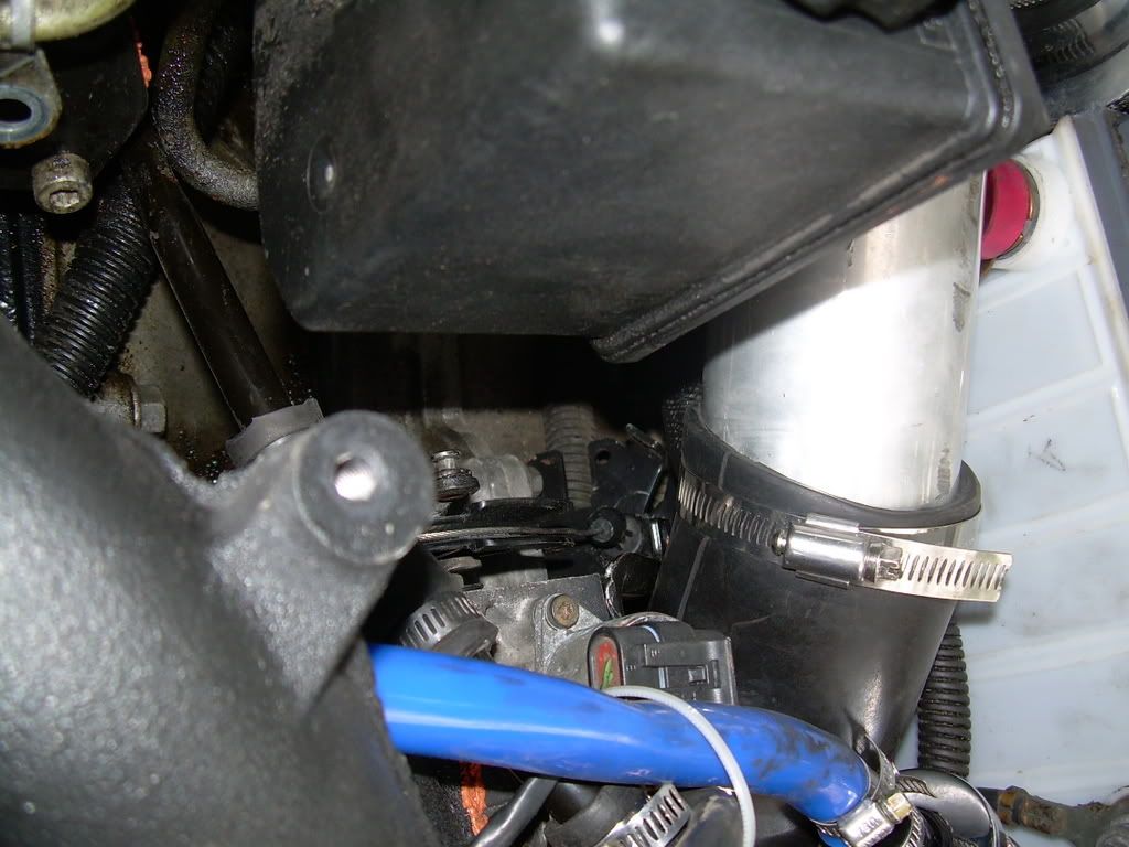

sorry, they are so big but you can see it better when its bigger. let me know if it helps, it might not be the best way but it works, also that is a 2.3 mani with a 2.4 throttle bracket. all you really have to do with it is elongate the bolt holes. best of luck to ya.

You'll want to use the 2.3 iac
Also, there is no vacume line that comes from the A/C.. The only lines that connec to the 2.3 TB, are the brake booster line, the black vacume line that comes out of your hanress and the line that connects to your EVAP canister.

now my tb must be diffrent then because i do have a vac line running from the a/c, evap, and brake and then on the mani i got vac lines running for map and fpr. runs smoother than it ever did before on 2.4 mani

Thanks for the pictures i see now how you installed it. Thats the way i tryed mine at first but it sits pretty darn close to the battery and when i looked at the other set ups it didn't look right. Ill give it another shot today and she if it works. If any one has a extra 2.3 t/b bracket you want to sell email me cuz i would rather use that one. Thanks for the info to every one who replied.
