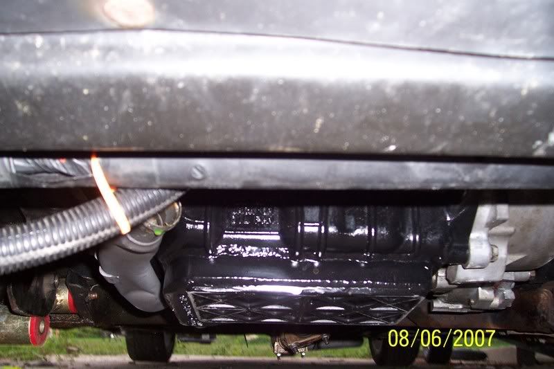

I sent Atomic a stock pan and he cut away eveything but the pan rail and the back of the pan which has the trans mount bosses and made me a custom 6.5 qt oilpan for my turbo engine. He can be contacted at atomicmotorsports@yahoo.com

Got any pics? How thick was the metal he used to fab it up?

Yes I have pics but I don't know how to post them here, I'm not sure what guage metal was used in the pan but if Atomic sees this maybe he'll chime in or even post pics of the turbo header, downpipe and oil pan he made for me.
