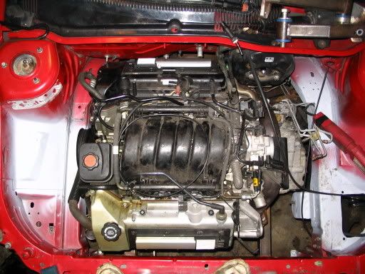

Re: 3.5L swap?
Saturday, July 05, 2008 12:07 AM
Ahem...
I didnt end up sticking with that engine though. I went back to the 3800 and put a turbo on that.
