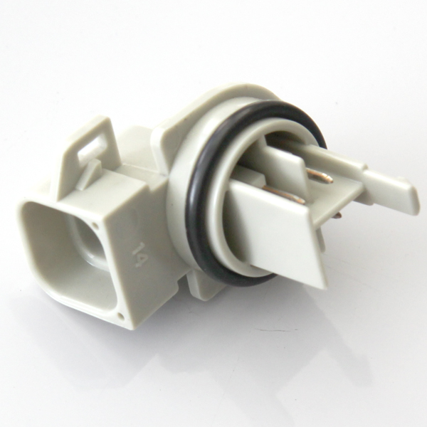

Well, I finally burned up the C-Body fuel pump I'd originally swapped into my fuel pump assembly... bought a Racetronix pump, went to install it only to find out the wiring is all melted where the bulkhead connector goes in. It appears there's a difference in the size of the connector between the J&N body cars and the W and larger ones?

I'm going to head to the wrecker and see if I can find the larger style one on a W-body fuel pump, as I don't want to wait a week for one to be shipped. If my C-body pump was drawing too much current for my piddly little plug, I can only imagine that other people here running the Racetronix pump in the stock pump assembly might end up melting the connector the same way I did..

Well, after trip to the wrecker's today... even the 05 Impala had the smaller pins like the stock J-body pump assembly has. So I'm not sure what the difference is...
The plug that comes on the Racetronix pump harness does not plug into the stock plug either. Close, doesn't fit. Going to have to modify it...

But.. as I already stated, I was already melting the pins on the bulkhead connector... so I'm going to swap to the beefier style which has larger pins for the pump itself. More info soon
Turns out both those bulkhead connectors I posted earlier are identical (150 series). Don't ask me why they have two listings on their site... Here's the melted pin on my stock bulkhead connector:
Replacing with the 280-series bulkhead connector, much beefier pins for the fuel pump itself:
And a side-by-side of the harness connection:
Which of course, required a swap to the 280-series style plug... so I snagged the FPWH-017 Hotwire hybrid pump upgrade harness (MP150S-4M to GT280S-4F) as well:
