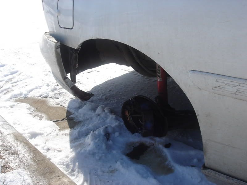

Hit some ice on my road and jacked a curb and this is the aftermath...

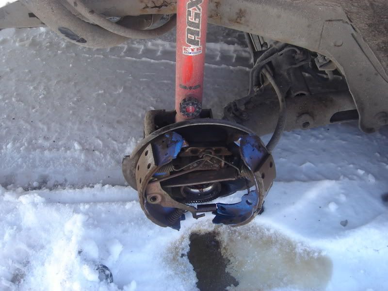

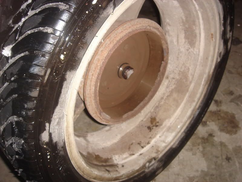

and this is the back of the wheel with the hub still attached
wheel was sittin next to the car when i got out and my first thoughts were that i just snapped the hub. i have not had the chance to get it up and yank everything apart to see what is really broken but i hope it is just the hub assembly any thoughts?

yea looks to be the hub from what I can see. gonna have to go over the brake assembly as well. but man car is starting to get some rot to it. might wanna get that attended to as well.
Re: Not sure if right place for this but had an uh oh!!!
Friday, February 02, 2007 12:20 PM
that'll buff out
seriouslt though. looks liek hub assembly snapped. you should be able to replace everything forward and be good to go. course ic ant see everything form the pictures

got it in the garage and up on some stands and yea the hub assembly just snapped, the bolts were a !@#$% so i had to just grind them off and ordered the new assembly and should be bolting her back together tomorrow and driving around with a jacked bumper so if anyone has a white 96 Z rear bumper they wanna sell cheap i may be interested

well the hub is @!#$, there is fluid there which means you rprolly blew out a wheel cylinder (for the rear brakes) over all it doesn't look to bad
