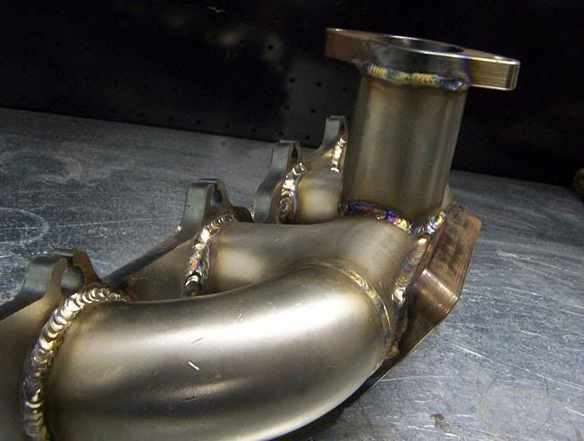

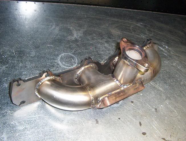

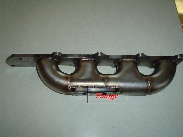

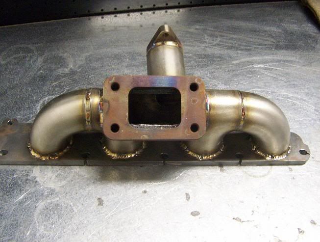

this was phils old mani. i know you have a 2.4, but just for pics.
2.4 ld9 log. ignore the flange drawing.

why its constructed with a WG port that only controls 2 cylinders is beyond me.
the flange should be center of the t3 flange to have better control of all 4 cylinder pulses.

stevefire wrote:why its constructed with a WG port that only controls 2 cylinders is beyond me.
the flange if offset, thus giving the gate uneven distribution if your theory was true.
With this manifold, the turbo will stay spooled and the wastegate will properly control boost. Honestly, the placement of the wastegate flange on a log manifold isn't super critical.

QBE (The Boosted One) wrote:english?
yes?
I think it should be in the middle, that's all.
