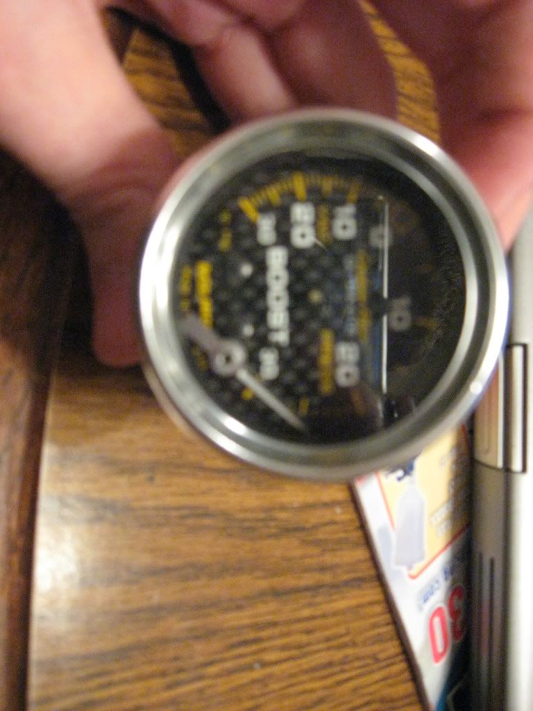

Ok that is my problem..... is there any way to fix this? I really dont wanna spend another 70 bucks.

call autometer, they will likely repair or warranty that issue

Well auto meter is closed right now, and i need this gauge on saturday, any other suggestions, i did buy the gauge off of ebay in september.

go buy an srt gauge for 5$ like i did..im sure theres a couple in a junk yard..other than looking for a replacment theres nothing you really can do bro.

Your solutions arent going to change man..call autometer. Or maybe get lucky and go sweet talk the dude behind the counter at your local shop. He maybe will be able to swap for a new one..just dont say ebay!!

Without calling Autometer, you might be able to fix it by prying off the trim ring. I have done it on several gauges with good result. The needle is just a press fit. Just make sure you press the needle back on at the line to the left of the 0 location. That is where they all start out as. If in question, with the glass still off and needle pressed onto the shaft, hook up your vaccuum line to it, and it should roughly read -15 to -20 at idle. Hope this helps.

That happened to my first one. You can get the bezel off, it's a tricky process but can be done. If pressing the needle back on doesn't work, you can glue it...but be REAL stingy with how much you use.

The Stock SRT Boost guage IS Autometer,
also don't bother trying to fix it yourself youll void the warranty. Just send it back.
