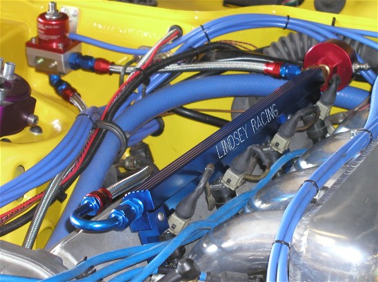

what kind of AFPR can i with the stock rail and fit between the timing case or can i thread the stock fuel rail and do something like this?
or pics of AFPR setup on your cars
Here is onecleancavy's

MadJack wrote:There are two Aeromotive AFPR for the LT1 motors. Check the application for each of these: Aeromotive 13107 and Aeromotive 13106
The 13106 has the mounting bolt hole on the correct side for the '94-'97 2.2L LN2.
IIRC the 13107 is used on the '98+.
13107 I beleive.
-MD- Enforcer wrote:Accel Adjustable Fuel Pressure Reg. ACC-74565
is what I have in my profile...I'm pretty sure it is correct.
I got mine from summit racing.
It is indeed the part number above.
Im not sure the aeromotive 13107 that goes directly onto the rail will fit in between the rail and the timing chain cover on a LD9, you may have to get crafty. I could be out to lunch on this one though

I believe I have the 13105, fits the stock rail but will NOT fit beside the timing housing without shaving the housing down and the regulator down.
I had a -6 aluminum bung welded to the rail and an using a 90* fitting between the rail and afpr.
I'm on my phone or I would post some pictures.
I had to cut the rail down before welding the bung on so everything would clear.
If you don't have access to a tig welder, you can cut the rail down and tap it with I believe a 1/2" npt which is close to 5/8" hole and get a 1/2" npt to -6 an adapter and thread it in.
I was originally going to go that route but I'd rather have a weld joint than a threaded joint.
