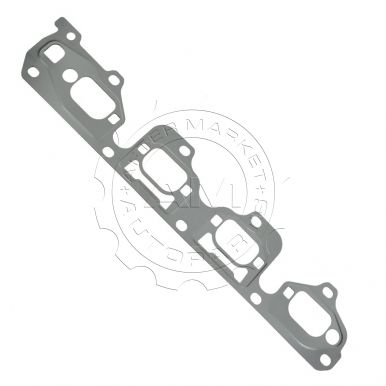

BUT, the factory exhaust gasket has port holes that look like this.
I don't have a comparison image, but I can say that the difference between the stock port size and the exhaust gasket is phenomenal. There is at least 1/8" bigger port size difference between the two. So now instead of being oval, the manifold ports and runners have been CNC ported to look like this.
