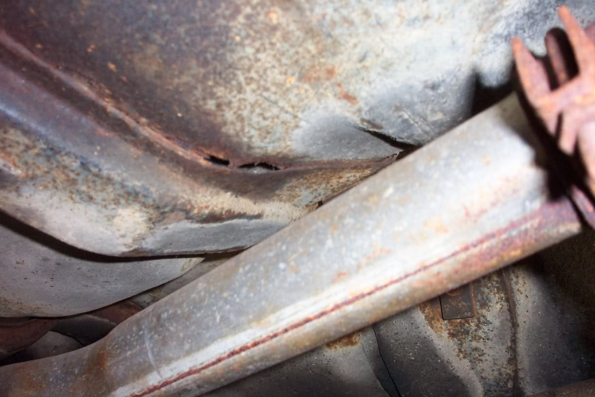

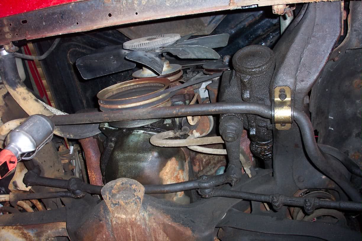

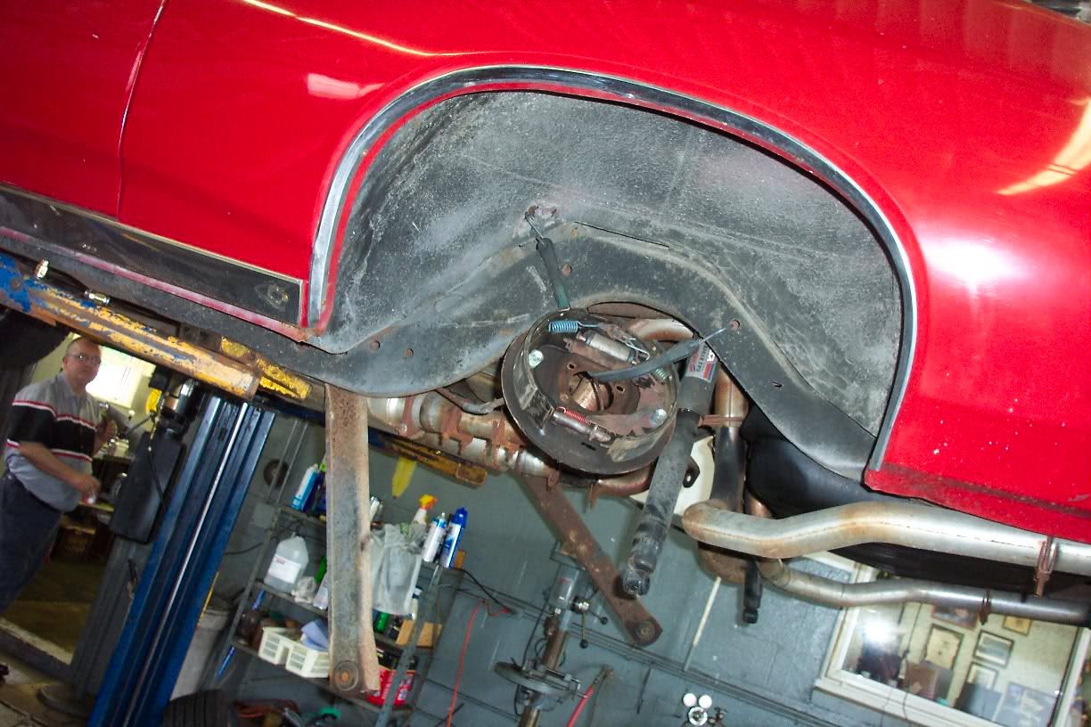

The car has been in the shop for the past several weeks now
1. Needed a new clutch put in.
2. Had them install the new gas tank since it needed the filler neck swapped to the new one

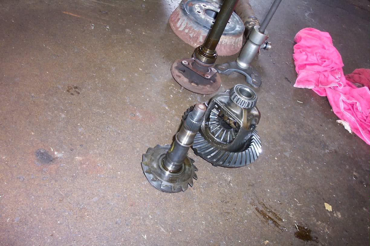

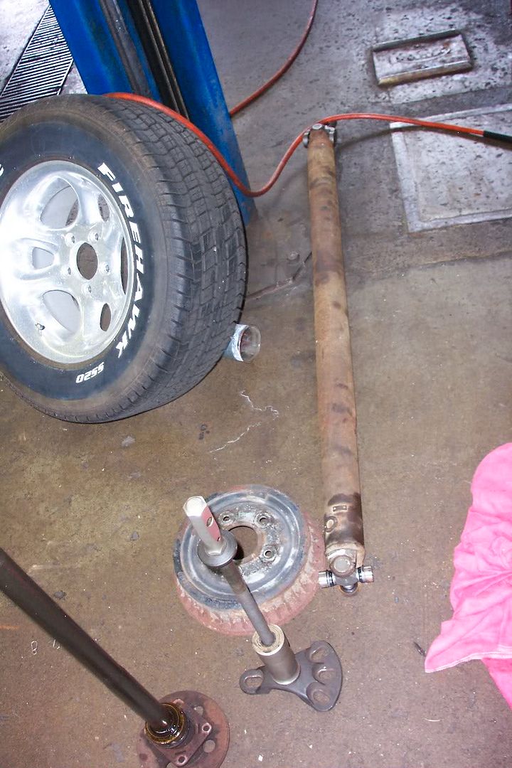

3. Now rear end is being swapped out since it had the wrong gears it had 256 and a open diff and we are having a 356 posi put in but come to find the rear end housing isn't correct its a canadian made housing and won't take the new diff correctly. The shop found a used rear end housing and possibly good components from a Chevelle. year unknown. They are going to check to see if the internals are what we need.
I took the oppurtunity to take some good pics under the car.

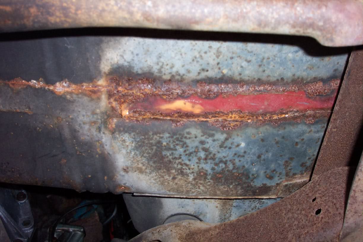

I found some areas that will need some TLC but overall not bad shape for a car form the 60s
Though I am afraid of what I'll find when I strip the front fenders down

I thought all big block A bodies had 12 bolts in em? Why not upgrade and ditch the 10 bolt....
That car will be a lot nicer to drive when the highway gears and peg leg are gone. I bet it will leave a helluva single track black mark though.
The goat is pretty rust free, especially for being in the rust belt.

balh blah blah i was just taking pic if they dont get it all reassembled today (which i'm doubting anyways) I'll try to get better pics of the differentials

yeah id say you strip it down and eliminate as much rust as possible in the next couple years
Re: Pics Of The Goat At The Shop No 56k
Thursday, August 03, 2006 1:57 PM
themarin8r wrote:yeah id say you strip it down and eliminate as much rust as possible in the next couple years
oh i plan to

only chevy used real 12 bolt rear ends , all other were 10's some had 12 bolt covers in the BOP cars
what diff cover was on the rear end ??
and he did say its a 68
