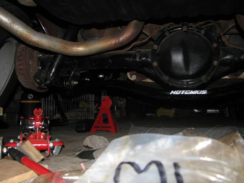

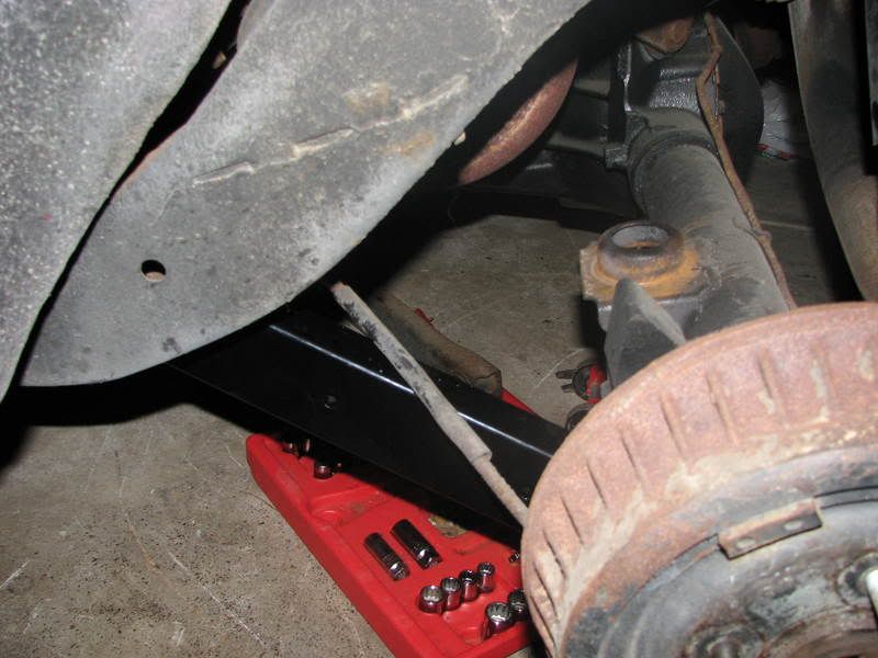

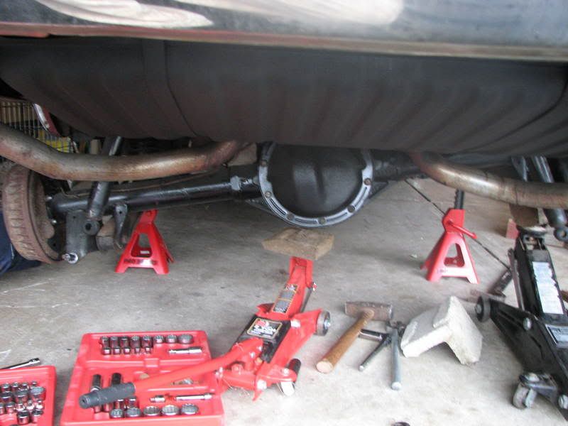

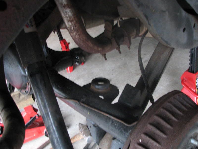

Started late in the day so didnt finish I hope to finish next friday or during the week right before woodward
the upper trailing arms and trailing arm mount braces will not be installed yet due to them being adjustable and I dont have the time to get them fined tuned yet so they will be done after woodward
Also the install was also done along with my brother
here are the pics

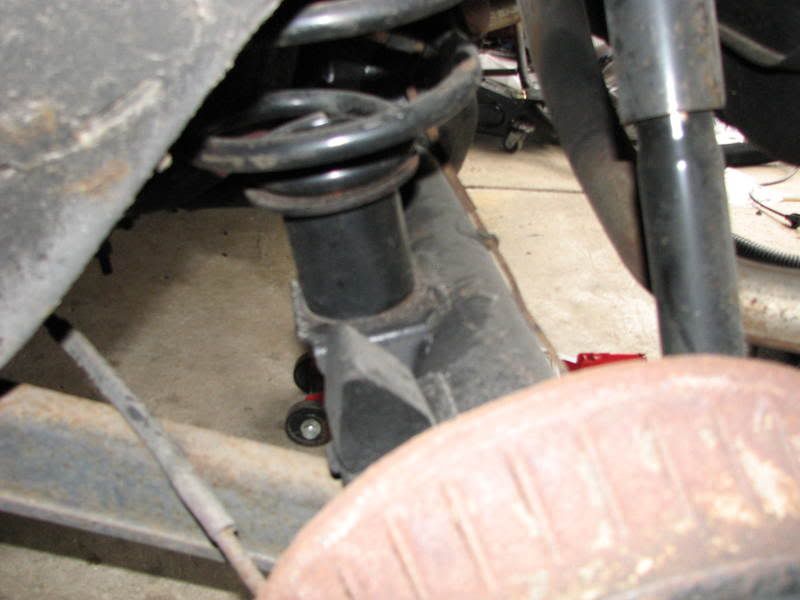

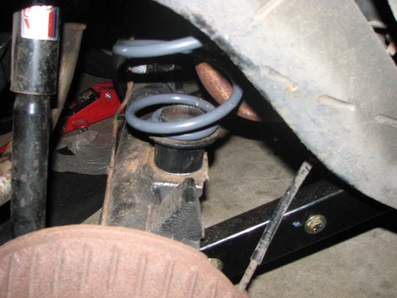

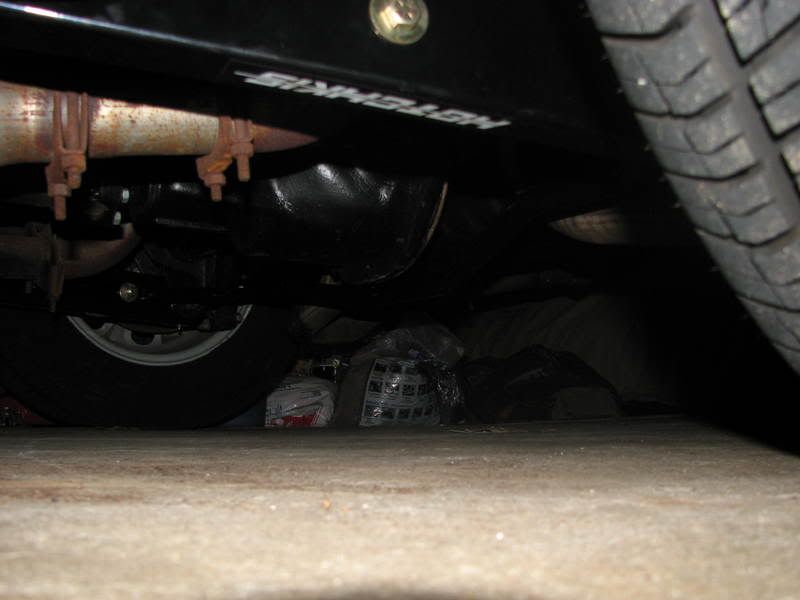

now the reason the car sits so high in the rear is some redneck put 3 inch spring perch lifts in

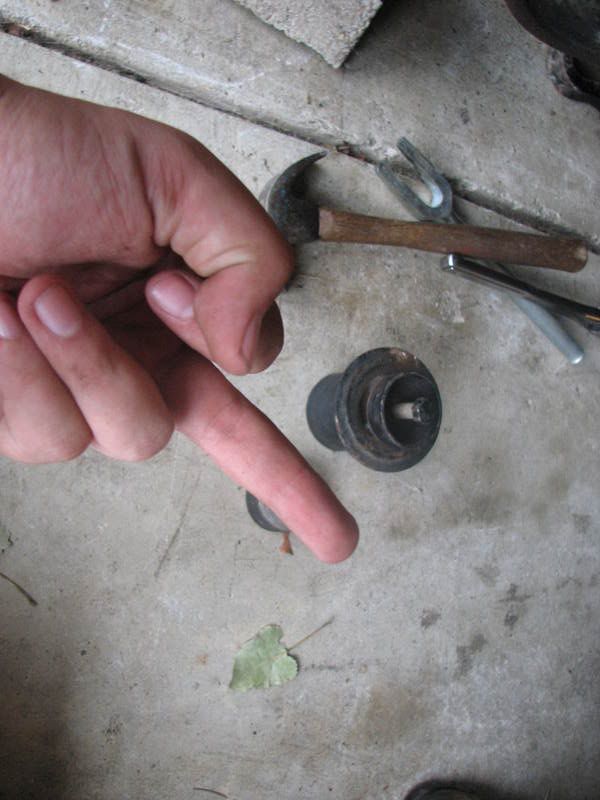

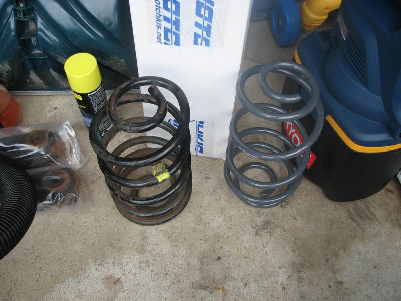

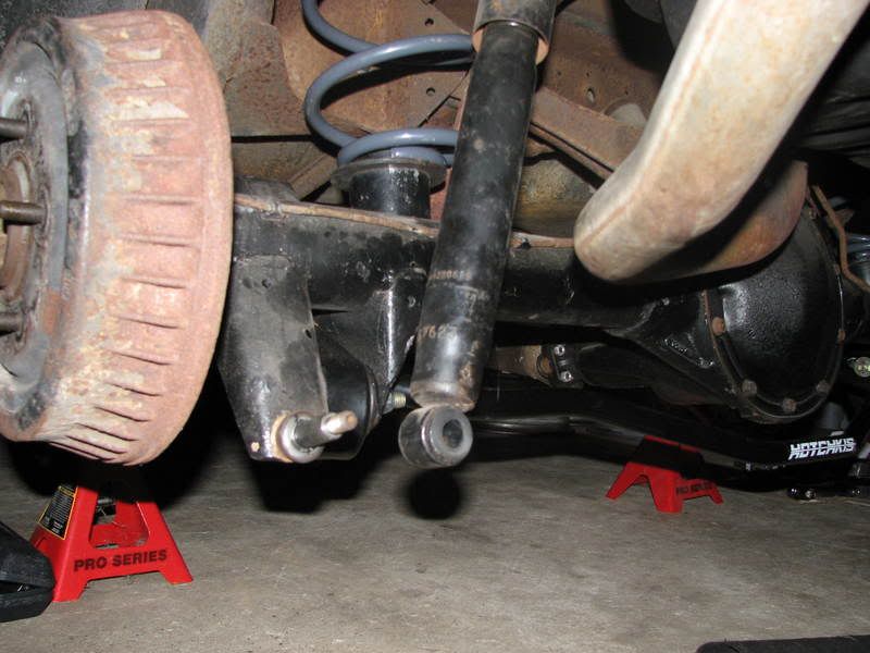

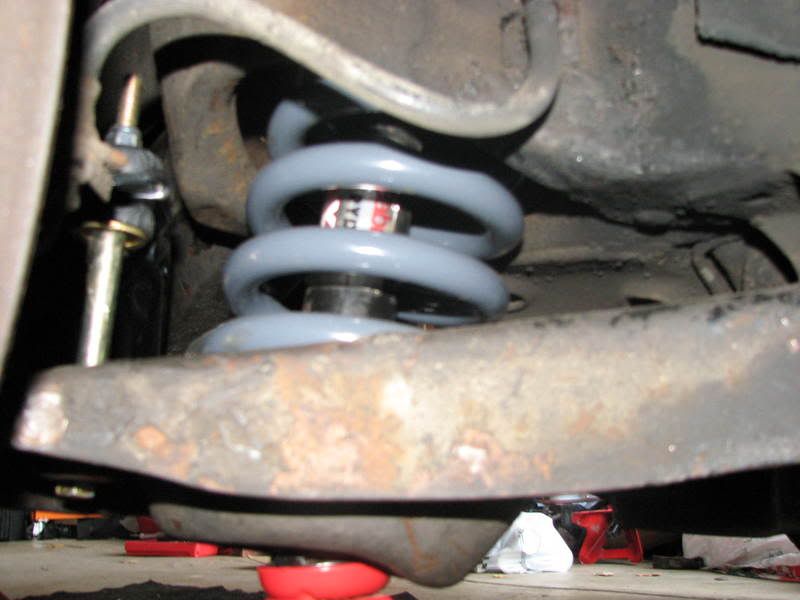

old spring and new spring (old seems beefier)

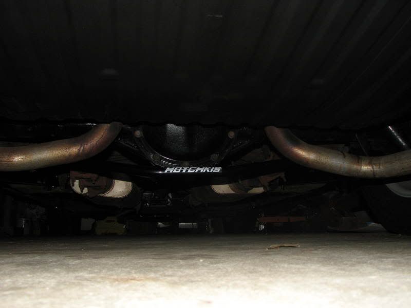

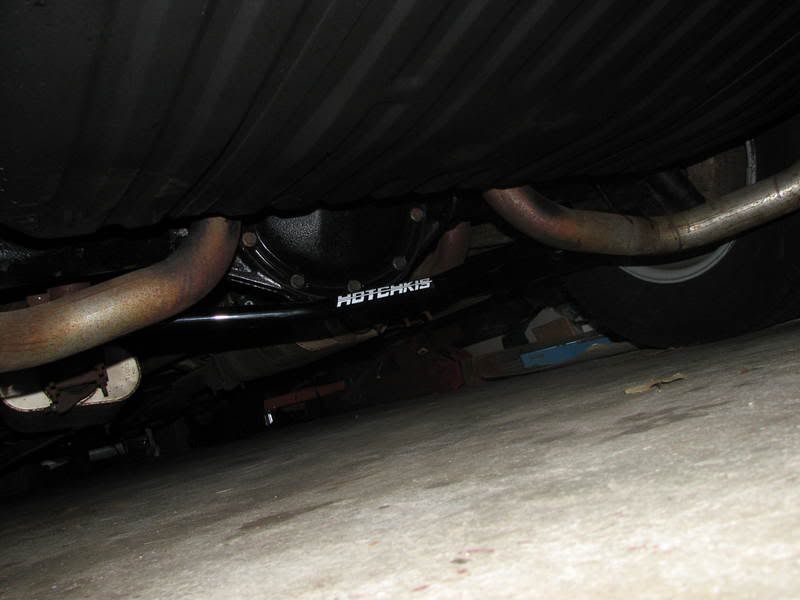

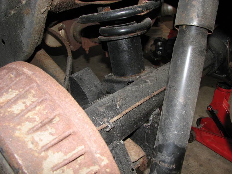

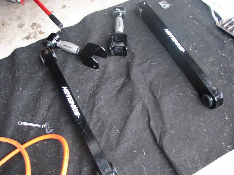

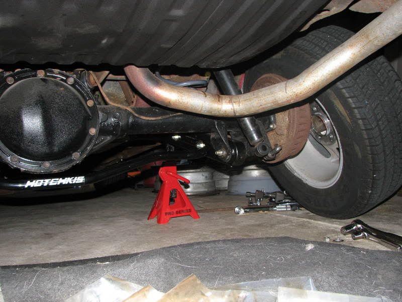

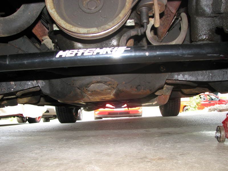

the upper and lower trailing arms (the mount braces are not pictured)

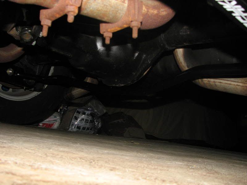

Well my brother finished most of the work except the uppers and braces but we will do those after woodward
for some reason the ass end sits real low compared to the front
so we may need to cut the perches down a bit and put them back in

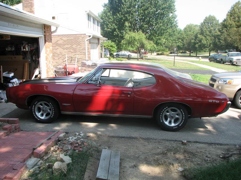

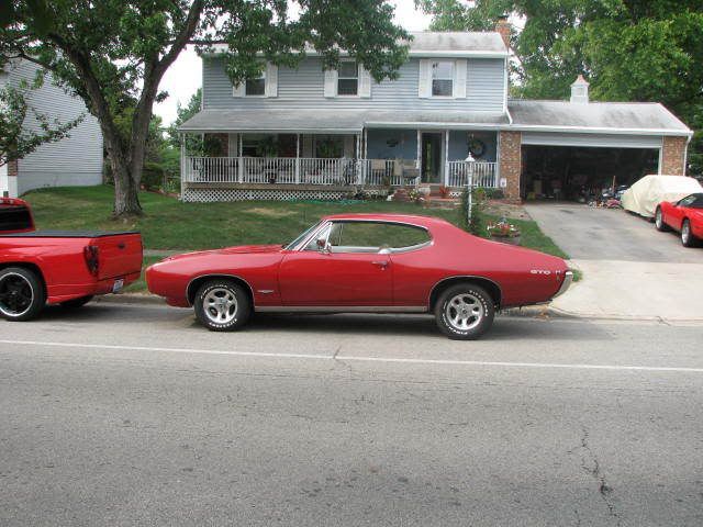

Saturday, August 11, 2007 7:54 PM

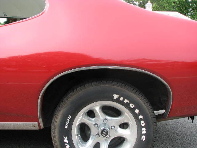

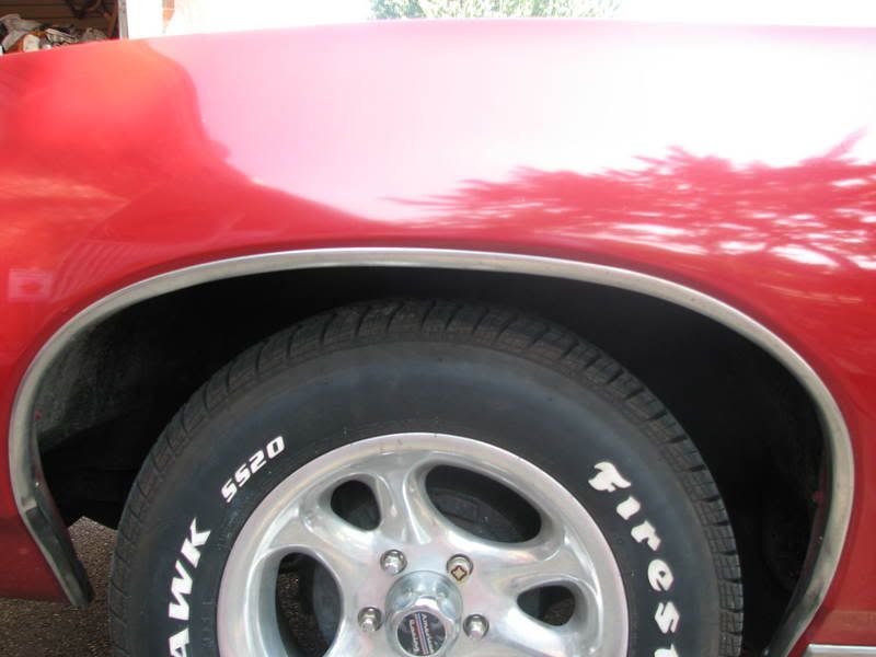

Day pics as promised

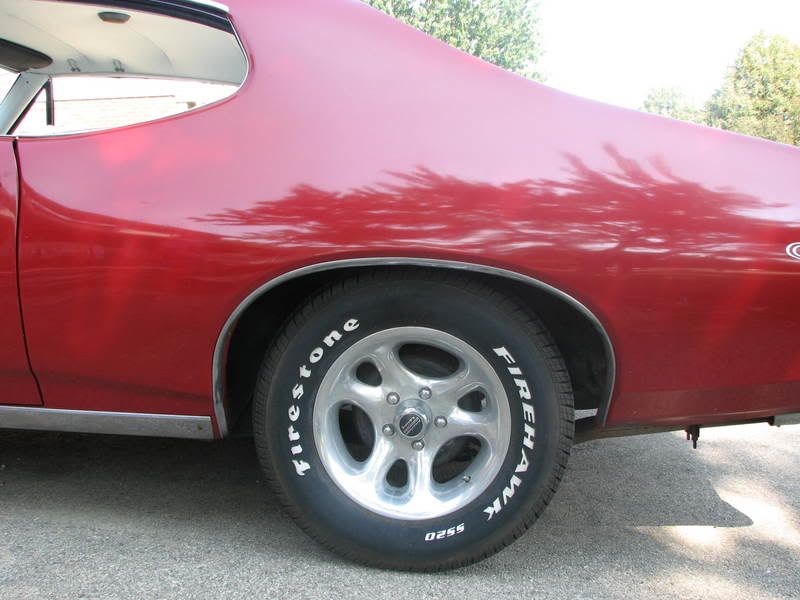

you can see the rear is kinda squating
rear gap
front gap
I'm taking the perches by a shop tomorrow to cut a inch out so I'll have a 2inch piece and a 1 inch piece and can swap them in and out
hopefulyl the car will sit better tomorrow

cut up the 3 inch spacers down to 2 inch spacers
and put them in
I'll put the shocks and wheels back on tomorrow and get pics of how it sits
Re: Finally Started The Rear Suspension Install
Tuesday, August 14, 2007 7:59 AM

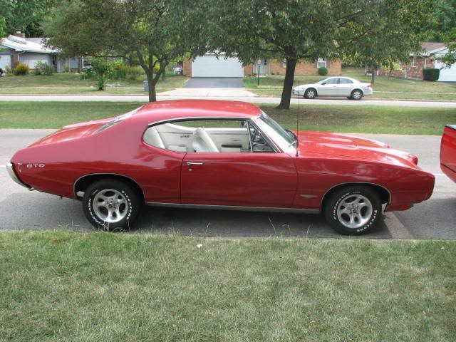

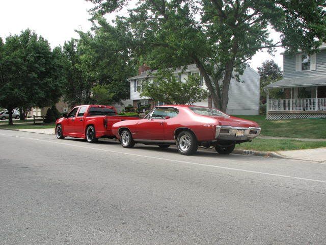

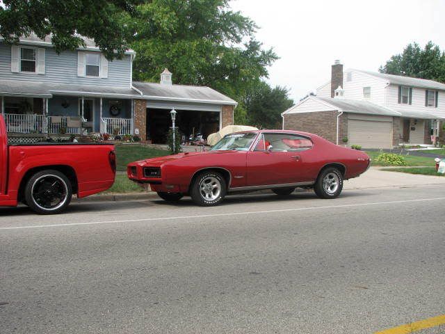

got the car back on the ground
the car has a small rake and depending how the springs settles and how it looks with the new tires i may go another 1/2 inch to a inch to get it just right
but here you go pics of the car on level ground
Tuesday, August 14, 2007 8:38 AM
ass end is way to high now , almost ready to give ya a nose bleed , the gap looked alot better before
my elco didnt have that much gap with new stock springs , and even heavy duty springs , granted im running 275/60/15's that are 28" tall
Tuesday, August 14, 2007 9:43 AM
[quote=97cavie24ls(™)]ass end is way to high now , almost ready to give ya a nose bleed , the gap looked alot better before
this is way better than before on stock springs and 3 inch perches now its hotchkis springs and 2 inch perches like I said I'll see how they settle but will probbaly take another 1/2 inch to a inch out from the perches
Tuesday, August 14, 2007 10:10 AM
honestly id take the perches out and just run the springs , if anything toss some airbags in it , and use a higher rated stock height spring
when they sit that high , traction/wheel hop and handling suffer , our cars handle better and hook up better if the lower arms are parallel to the ground , then use the uppers to alter the pinion angle , and you got a great set up
i like the old school muscle cars with a rake also , just yours is a little extreme

I tried that here
rearend sat lower than the front
and trust me this is lower than the rake it had before by about 2 inches or so

hard to tell from that pic though because of the drive way slant , but it looked better to me in that pic , just needs air bags
how many miles have been put on the front springs ? and since i never asked but , the front tires the same size on those wheels or are they different ?
best tire sizes in 15" are 245 or 255 , 60/15 front and 275/60/16 rear , fills the wheels wells up nicely and gives that nice rack look

not many miles on the front less than 80 miles i'd say
currently it has 235/60/15 in front and 255/60/15 in the back the new tires are 215/70/15 and 235/70/15 i was limited on size for red line radials
