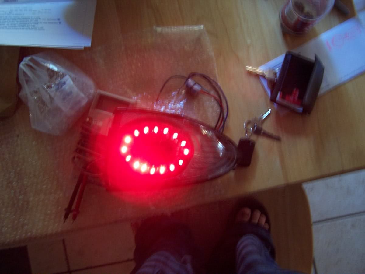

i cant find the old page, and this is kinda different anywaz... so here we go...... i have been working on these for a few days now, and this is what i got. i want to get everyones ideas here and please... be straight up. i dont want to over look somthing, and be regretting it when i gotta take these dam things all back apart 2 months down the road.... thanks

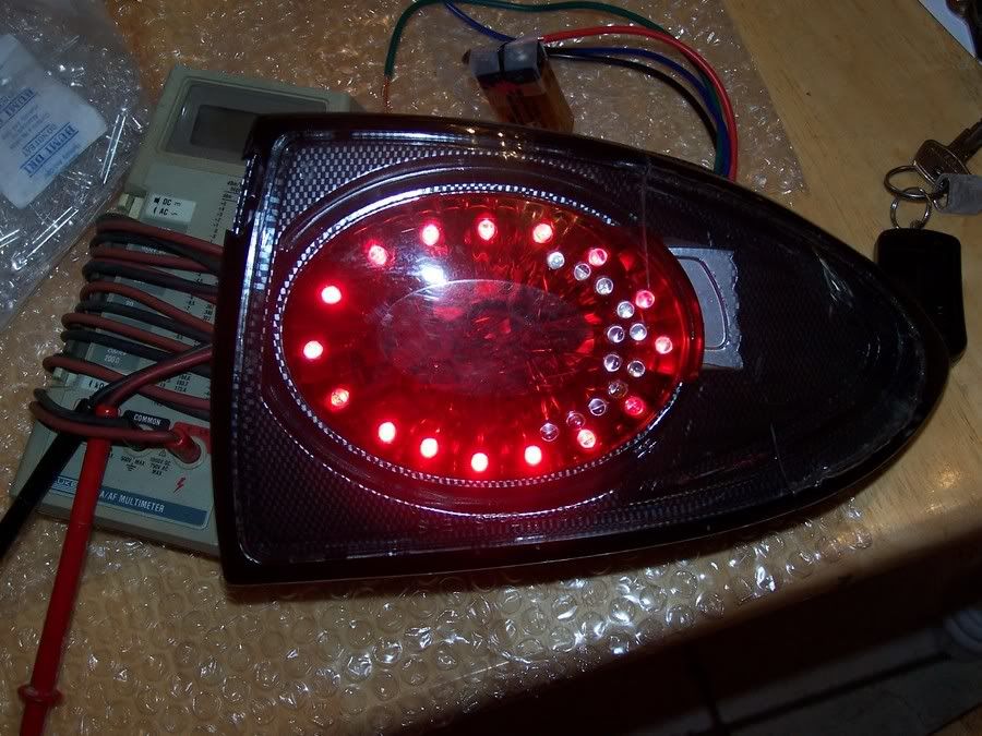

Looks hot dude! I'm lovin it.
Re: well here we go again... led tails
Thursday, November 10, 2005 10:14 PM
no, props on the work but the doughnut needs to be filled.

FANTASTIC job......
BUT, the fake c/f has to go. please paint it.

Or somehow get some real c/f in there. Paint would look good too. I'm just not a big fan of the fake c/f look either. Looks good to me other than that. Props on the work.

1) hate the fake CF look (been there done that)
2) Put the turn signal at the edge of the tail light to fill in the gap there

You could probably put a red led replacement bulb in the original socket and use that to fill in the gap.

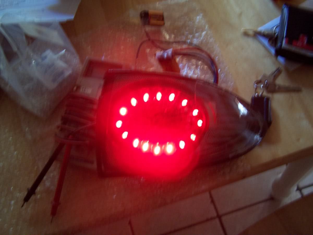

ok, on to the fun, i mounted the tail last night, and i realized i @!#$ up pretty good. me not thinking, i mounted the leds like the tail was sitting flat on the bench, so the leds poing about 20 or 30 degrees out instead now... haha time to redrill some holes!!!

yes thats only a 9v. i dont know how much the car puts out for running nights, but it has been explained about 1/2 to me. so when you hit the brake the full 18.8v hit the leds and they brighten up. quite a bit. as far as brightness, when i get them aimed right(had to dis assemble the whole dam thing to do this)you should have no problem doing this, and somone shouldnt be on my ass close enough to have to worry bout not seeing them.... haha. the turn signal as you can see is seprate, i ran power to them and was having problems. so i figured since i had to rip everythign out, i would @!#$ with it later. but like i said, there should be NO VISIBILITY ISSUES DURRING THE DAY. thanks guys keep the thoughts comming

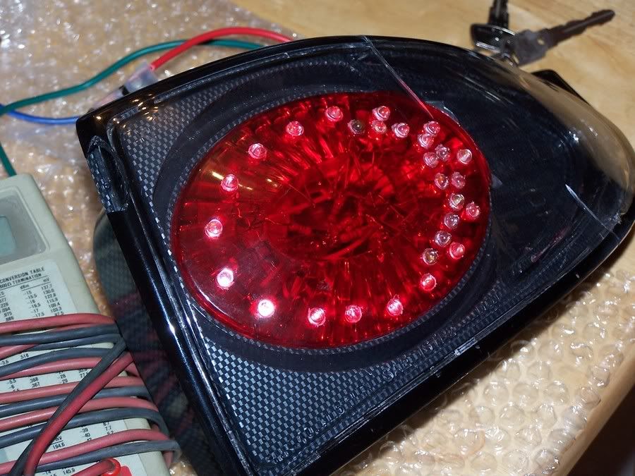

hmmmm i have come accrossed a problem... haha remember how i said that it should be fine in the daY???? well i was basing that off of a big ass light i have in my shop, that and i could see it fine. well i took it outside today, granted it is on a 9v battery, not the 12-14 that the car runs that it was set up to run, but it is kinda hard to see when the sun is directly on it. from anyone else that has done this, would a tinted lense help? i woudl think it would either prevent the light from interfering with the leds, or the other way around and prevent the light from gettting out... tell me what ya think on this one....

you cracked the lens but it looks good

What I would do is this, run the test off the car's electrical system and compare results. By using a 9v battery, you already have an intensity problem right there as the resistors still doin their job. Just pop the hood and use the car battery. Run 1 test, engine off, and a second test engine on. Make sure it's in direct sunlight.
Doing it that way will have a visual test of 12V-ish to 13.8-ish and if it still didn't help, you may need to step up the intensity of the LED's

@z24: K, now we're getting somewhere. This is what I think is happening.
Since you have the LED's exposed, the overall intensity of the sun is overpowering the intensity of the LED's. Also, it could be that the viewing angle of the LED's when compared to the ambient lighting (sunlight) is posing a conflict.
There would be now 2 solutions -- one is a rework of the design and have the LED's recessed in (the recess will act as a "shade" for the LED's directing the light, and hopefully blocking the sun. The easiest way to do this rework is to mount the LED's to a board of some kind (PCB, Perf, etc.) and mount the board afterwards, behind a clear lens. This rework will also have more symmetry in the overall LED layout as well
The second would be to add LED's, but with them exposed, I'm more than certain that the same problem will arise.
Welcome to the world of trial and error...
As for the stock tails, most if not all, will be hard to see in direct sunlight, I'm sure you've witnessed it with the older, non-transparent, tails. Heck, my stock Fire tails do the same thing.
