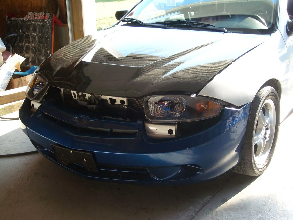

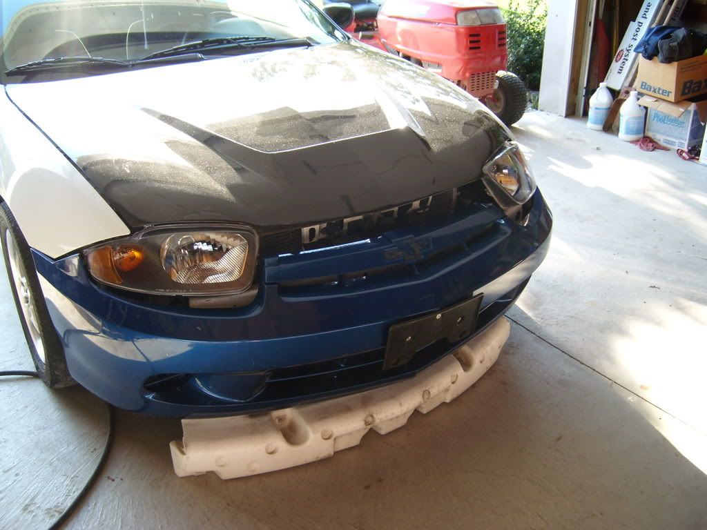

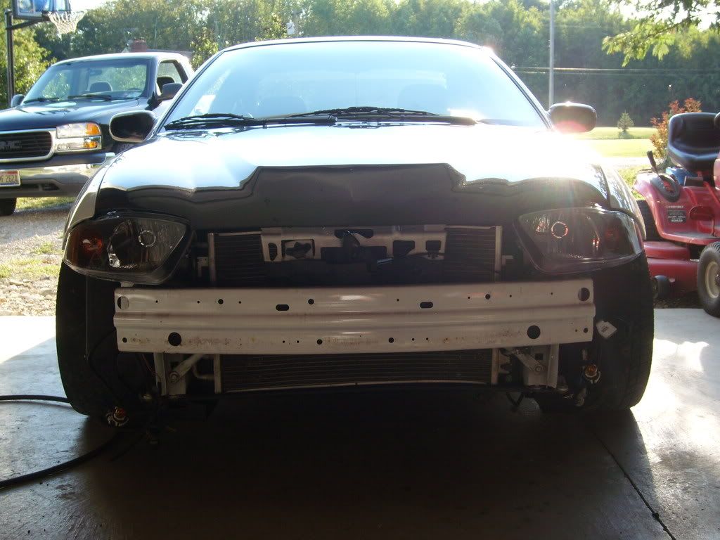

Alright so I took some pics. PLEASE HELP ME....
No clue where these bracket things connect to...
Where do these holes go? Right Behind the bumper molding.

The tabs go to the crush guard and the holes are suppose to have "L" brackets on them that bolt to the metal bumper.
Re: 03 Cavalier Front end swap
Thursday, September 18, 2008 10:42 PM
Yep, you need the crush guard
Friday, September 19, 2008 5:26 AM
ur bowtie strip on the bumper comes off so u can get to those screw holes and there are 2 l brackets that bolt on to ur impact bar to screw ur bumper to, and the 2 tabs that are lower use plastic push pins that go to the bottom of the crush pad.
