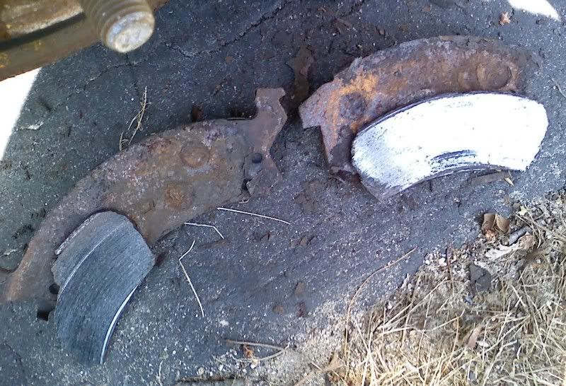

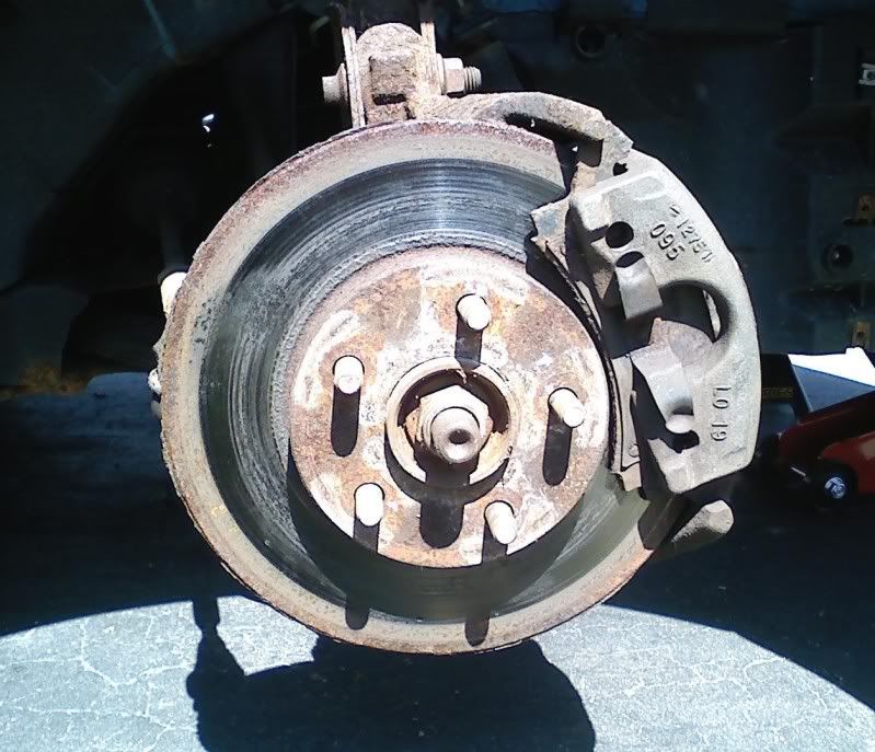

For anyone interested, this is why they were squeaking:
Break pads shouldnt do this:
Before:
After:
Looks good Jess. You shoulda painted the knuckle and stuff while you have it kinda apart.
Thanks... It's getting slotted rotors in time, so when I do those I plan on makin it look a little prettier under there. For now, I just needed some good working brakes, lol.
Damn dude. Those were shot.
hooooooooooooooooolllyyyyyyyyyyyy Shiiiiiiiiiiiiiiiiiiiiiiiiiiiiiiiiiiiiiiiiiiiiiiiiiiiiiiiiiiiiiiiiiiiiiiiiiiiiiiiiiiiiiiiiiiiiiiiiiiiiiiiiiiiiiiit
wow... i bet your brake pedal is ALOT stiffer now....

Haha yeahhhh, they were pretty bad. lol.

After seeing the pads just crumble apart upon removal, and one pad completely missing half of the surface contact where I showed in picture... im surprised it stopped as good as it did, lol.
