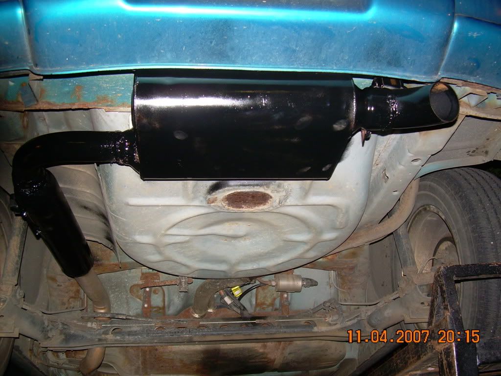

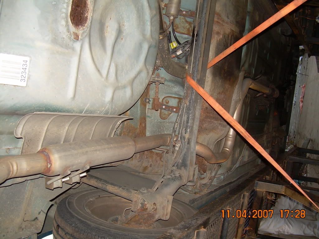

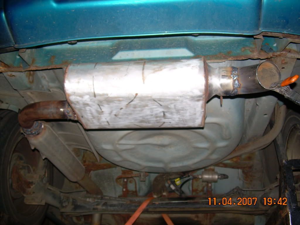

Yeah i finally got mine quiet, it has a 26 inch glasspack feeding 6 inches into a flowmaster (40? series) muffler, sounds great, like weebel and whiteboy said the longest you can fit is better to control raspiness. For alomst 9 months i ran just the glasspack on the street and luckily got away with it. Really no boltons though. good luck on it though. Here is a pic or two.
unfinished
finished and painted
how it was before finishing it, you see it ended with that turn down behind the glasspack
