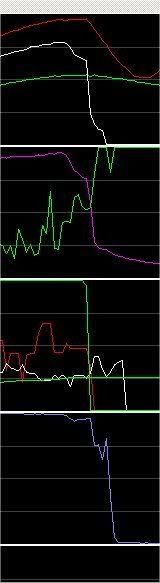

Re: GM 2.0 BAR map "fuel cut" --- "over boost"
Sunday, February 04, 2007 6:51 PM
then why wouldn't GM cut all the fuel, instead of 20% or so... see pic
injector duty cycle is at the top, map is purple on #2
