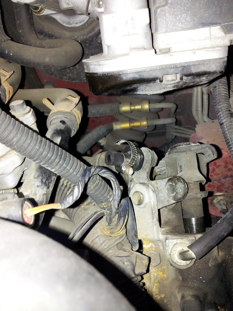

Very productice day today! Changed a strut, my sway bar links, my reverse switch, and i noticed one of my shifter cables was just barely hanging onto the post it was supposed to attach to. Its like the middle of the cable grommet just vanished
I improvised a solution by finding a section of hose that would fill the gap in the cable end, but still snugley fit over the linkage post
I then used a small hose clamp to hold everything together. It will do until i replace the cables, if i do. If the rubber holds up to the heat, i may just leave it.
I now need to pull the console and check the other end inside the car
