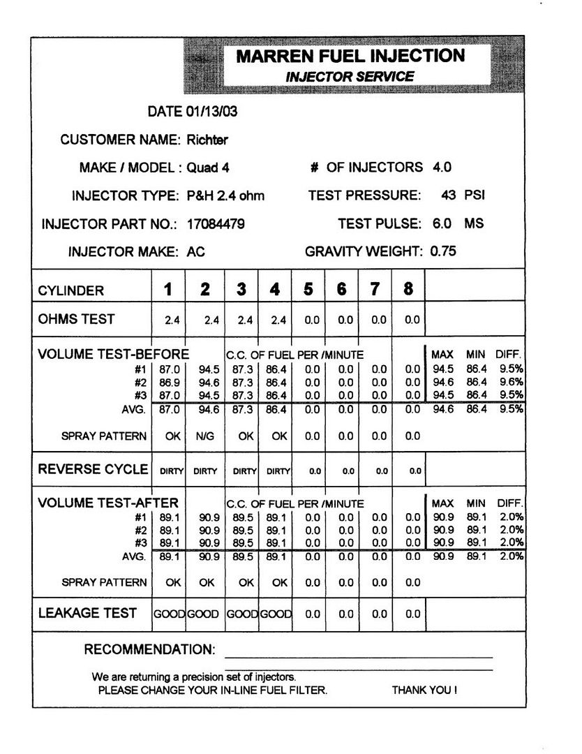

This should help explain what the HO's are size wise, etc.
