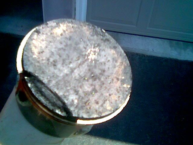

well this engine was bought as my build up motor. as far as i know, the cylinder walls are fine, they will be bored 0.020" over for the wiseco pistons im putting in. i have clevitte main AND rod bearings already to go in. and the will sit in some eagle rods. im planning on doing the crank work also(knife edge, cross drill, maybe lighten? and then balance).
the head is the only thing other than the piston that has visible wear. i didnt get a chance to get pics of the head today but here is the piston.
nasty eh? oh and just for the record, there are no sleeves on the 2.4 LD9 haha. if im wrong with that im gonna feel like a tool.

kinda useless to buy rod and crank bearings before you know what the crank is gonna clean up at
unless you got a spare good crank

Wednesday, June 07, 2006 9:18 PM
not if the bearing spun , it usually destroys the surface , which requires turning if saveable , and requires over size bearings

^ ^ ^ Is right. You need to see what the machine shop turns the journals down to so you can order the correct bearings.
