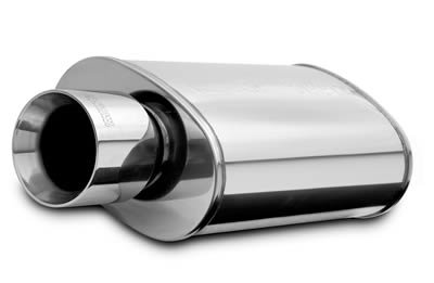

I'm trying to get together all the parts to have my exahust welded up at RDFABS in the next couple of weeks, This is what i have right now...
- Pacesetter Armor Coated header
- Magnaflow high flow cat 2.5"
and 2 of these magnaflow mufflers..2.25" inlet /4" outlet
Unfortunately were are unable to get the tubing in 1/4 incraments, so.... 2.5" primary from header all the way back to the axle then Y- off into 2" tubing for the duals out underneath the type-j bumper. I know you NEED the resonator for the RKsports magnaflow dual exhaust, but i am not sure since these aren't the fart cannon mufflers but i still want some vrooom sound from my car. I just don't want to put one on and have it be too quiet... What are you opinions?
THanks..
