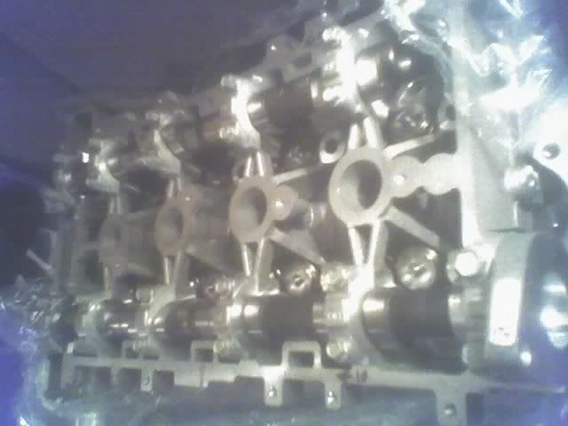

Ok, so it's finally done. For those of you I haven't already talked to this about, I bought a 2.2 eco from an 05 Cobalt that had 1,100 miles on it (from RK Sport's ebay store). I already have an 04 cav with the gmpp s/c w/ intercooler hooked up. But before putting the new engine in, some new goodies came in (sorry for the quality of some of the pics)...
Patriot Stage II Head
Comp Cams Blower Grind
Eagle Rods
Cometic Head Gasket
ARP Head Studs
I also got Wiseco 10:1 with .020" overbore pistons but I don't have a picture of them when I got them in.
TurboTech Racing Upper Motor Mount
RK Sport Lower Motor Mount

I can really tell a difference in how it runs. I can tell it really wants to take off especially top end. Actually, it's revving so quick, it's having trouble shifting at times, as you can kind of see with the 1-2 shift on the after pic. Surprisingly, I'm actually seeing higher boost numbers, too. Instead of maxing about 10 to 11 psi (before swap w/ intercooler), now it's maxing about 13 to 14 psi (after swap w/ intercooler).
When I first started up the car after the new engine was in, everything felt completely different, it's hard to explain, but I can tell it's just begging to have a smaller pulley on the s/c and higher rev limits for starters.
