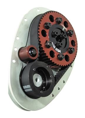

Bob Guptill wrote:something like this
http://store.summitracing.com/partdetail.asp?part=CCA%2D6504&autoview=sku
Nice, Bob... But what about the plug in the lifter galley that supposed to vent said galley of air & lube the chainset? Would we change the plug or just make the cover on this to allow it to still do one of it's duties?

the sbc chevy has that plug there to and i think it still sits behind the cover and drains to the oil pan, where this has a belt no lubrication would be needed
