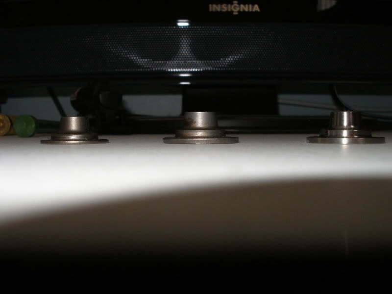

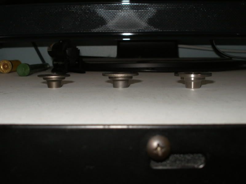

I dont have any pics of that set up but as I stated its not ideal. I switched to teh 2.3 retainers because I just didnt trust the 2.4 retainers 100%. I still was not 100% satisfied with the 2.3 retainers. That was why I had the Ti. retainers made, but scraped the build before I could try them out.
2.4 and 2.3 for comparrison.

so basically the 2.4 are only a small amount smaller then the 2.3 retainers so might be ok to use, Im questioning it, if only I didnt lose the 2 retainers

I would not recomend it but it can be done. They are a lot2.3 retainer but do the spring where it belongs.

Its very hard to tell but the Ti. ones are a copy of the 2.3 retainer but have the ever so slightly smaller 2.4. keeper pocket. My only concern with the 3 retainers was that the keepers sat to low in the retainer for my liking. The chances of them ever coming out are slim to none but its all personal preferance.
