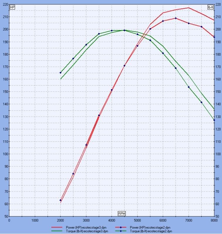

I suggest you download Desktop Dyno, its very accurate and you can play around with things like cam timing and see the affect it will have on your power curves. Its loads of fun and it takes alot of the guess work out of motor building.
As an example I entered my build for this year, only differance as you can see is one set of lines is the Stage 2 cams and the other the Stage 3 cams. It's not bang on, but I bet it will be pretty damn close.

Before anyone freaks out, the program only outputs HORSEPOWER and TORQUE at the CRANK....lol
Just wanted to clear that up.
