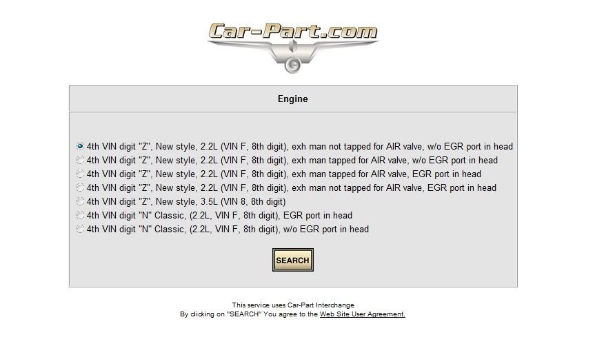

The car I have has a 4th VIN of "N" and 8th "F". Looking it up, it seems there were like 6 different 2.2 ECO's put into these cars. My combo being the most unusual. It is only $300 price difference between the two locally, but if I can swap over manifolds or make an EGR block off plate to save $300, I am all for it.

I was using www.car-part.com and it listed 6 variations. Which had me confused. So worse case is fuel lines, and maybe a mani swap. I have the engine listed int he very bottom, without an EGR port in the head. See, the Malibu came in N body form and also the new style, that most people see as the MAXX although there were more than just teh 3.5 MAXX motor installed in that year.
Thanks for the input, and hope this shows why I was confused. Seems I wasted a lot of time on learning about the Quad 4 motors.

Car-part is good, in general... but it's not quite right in all instances. See it lists the top three as VIN Z, but then later in the parentheses it's changed to VIN F. The Z would mean it's the LZ4 engine, the 3.5L with the VVT option. They don't even list the 3.5L without the VVT..
So, you don't have an EGR system on your engine? Then the port could be blocked off, if you happen to get a block that has one.
