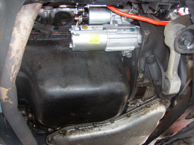

Got the starter in today, thought I'd share a few photos. Hopefully you can see how much smaller this unit is.
One GOOD thing is it is lighter which helps in installation.The stone cover fit perfectly too.
I also used...(recycled) the old battery cable from the starter housing back to the battery for a better current flow. I used double terminals on both sides of the battery. I used long bolts so I could use all the threads in the battery for the best connection, and tightened up the terminals against the battery with a nut along the bolt threads, so I don't have to worry about stripping the soft battery threads.
In case anyone wants to know, the bolts are 3/8" standard thread 2 1/4" long overall with the threads running 1 1/8" long. Bolt head is 9/16" I know everyone has their own solutions , just thought I'd share this. Also there is enough clearance to remove the bolts without pulling the washer reservoir, but you'll need to remove the battery hold down and tilt the battery back as you go. I just don't think much of those small 8mm bolts that hold down the battery terminals, have stripped a couple of battery threads in my time.
Finally, I took a shot of the alternator. The Diode Trio sits just about 1" above #1 exhaust pipe, thats a lot of heat there, especially in the dead of summer, I think this is just a bad design, and contributes to alternator failure. The OHC engine doesn't have this problem.
In the end everything worked wonderfully!! :-) In another thread, I wrote I couldn't find the plug to the Lockup Clutch Solenoid on my 84 Pontiac. Eventually I did find that, carefully hidden away. I guessed the solenoid probably sticks. The Pontiac seems to run so much more smoothly , that I decided to unplug the solinoid on the wagon and test it out. It ran a lot more smoothly too. That clutch kicked in around 35 mph, which just seemed to be too soon for me. Also it didn't want to kick out when I needed it to as I drove here in the Virginia mountains. I'm sure everyone has their preferences, just found this worked better for me. And, most importantly, disconnecting the solenoid DOESN'T throw a code!!

Neat stuff there.I see alot of oil residue on your pan gasket area.I can tell you if you do replace the pan gasket,there are some recommends I can make.1 totally strip the pan get it super clean inside and out(bone dry before install).2 I would paint the pan with engine primer(duplicolor) several coats,then same brand on paint(color I used semi flat).3 only use the cork gaskets on the sides,I found on my 2.0 that the short gasket at the crank slides out when compressed!.4 I ONLY use permatex the right stuff gasket sealer(seals it forever).and cures quick.5 I ran a bead two rows on the pan at the crank halfmoon,run a small dab on the rubber gasket at the flywheel(you will be glad if u do)both sides of it.Mine leaks a touch and did not do this(!#@$%%!).6As for the cork run a light bead on the pan apply gasket on sides then a light bead on the other side.Just install the bolts all hand tight to start.7I installed the bolts side to side initially then torqued BY hand in a clockwise direction.These bolts can easily be stripped and a good snug fit will work.Make sure to put conduit on that new starter wire too.I kinda got carried away.Starter looks pretty too.If you want pics of my resto I can locate my post on it somewhere here.I sandblasted my pan and cleaned my oil pump and yes new gaskets for it.

All that oil has a story of it's own. I had a horrible oil leak over the past few years. For the first 5 years I had it, it never used any oil, then on day the oil light snapped on, and from then on, it just went down hill. I was going through a quart in about 70 miles or so at the end. Eventually I discovered the source by accident. It was the valve cover leaking on the back side around the intake . I tried using one of those neoprene gaskets, but that was a waste of time. Finally, I got a good ole fashioned cork gasket and "Got Er Done" :-)
I did take a look at some of your earlier threads (you've been a dedicated and busy J-Body owner!!) Saw some of your work on your oil pan - Work to truely be proud of!! I also saw where you had some troubles with the manifold wanting to kiss your starter too, and how you fabbed up a copper extension for the battery cable to bolt to. At least that helped me to appreciate the smaller, shorter design of this starter I put on. LoL, I didn't like that thing until I saw your picts.
So far the oil pan is snug and not leaking, hope it stays that way too, 'cause from what I've read on the threads here both OHC and OHV oil pans are a real PITA !! But I copied everything you wrote on here and saved it so when I do, I'll have the benefit of your experience!!
