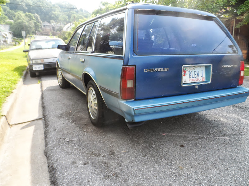

Well, noticed the ole rust popped up the paint while I was off on my 5 day break so it was time once again to work on the wagon's top. I had promised myself when this time came around it was going to be time to do a proper sand down and repaint of the entire roof section. Sanding down a "Longtop" is a chore and I swear I had to run off a couple of Piper Cubs trying to land on it while I was working.
This old J has really taught me a lot over the years. It is more than a little sentimental. I blew through this project in ever short amount of time as I get more experience at what I am doing. 5 hours with the 1/4 sheet sander and it was ready for painting, and this top was in horrible shape since I had at least half a dozen patches on it with some thick coats of paint on some of them! I used 60 grit this time and kept the air compresser running - blowing off as I went along. Used just 2 sheets of sandpaper on the entire top! Rolling the paint on quickly is benificial as it allows the different sections you are working on to blend in together - so the quicker the better. Not too fast to be a sloppy job - there is an art to this stuff. Art is an interesting word for this kind of painting since I wind up using art & craft brushes in the drip moldings and then dab a foam brush at the areas above the drip moldings to remove the brush strokes and blend in with the foam roller area.
2 Prime coats, 2 color coats. The enamel paint it about 2 years old in the cans but just as fresh as the day I bought it. Put the gallon into 4 quart cans when I got it so it doesn't skin over.

Budget painting - I used old fashioned masking tape. I use the thick roll though - covers much better.
Tried to take the paint down into the old primer , but some places wound up getting down to bare metal. The 60 grit sand paper worked well, and not much build up blowing off with compressed air. Placed a fan to my back to help blow the paint dust away - really helps!
Top Tip!! Buy some cheap bed linens at the thrift store and use to cover car off with them! Very effective - quick to tape up and re-usable!! They are Great!!
Like I said above - art brushes and foam brushes are great for getting into those drip rails! Glass Jars are great - just wipe the top off and scew on the lid. Much easier than cleaning the top of a paint can!!
How to initially soak the foam brush....Dip end in paint
dab the end on a piece of cardboard - a cerial box or pizza box does great!!
Then roll the roller in the paint to get the foam full of paint.
And 1st primed coat is done
Here are a couple of good shots of the drip rails being painted first. The blue shows up well over the primer.
Oh yes - wrap up your paint can in aluminum foil and you don't get paint all over your can.
1st color coat
And after 2nd color coat with all the tape removed. Takes about 1.5 hours to paint in the drip rails and along the back hatch then roll on the top each time. About another 1.5 hours masking up time. About 8 hours altogether plus the 5 hours sanding makes about 13 hours.About 1/2 hour removing all the tape. Oh yeah about another hour removing and reinstalling the roof rack. We will call it 14 1/2 hours. To bad I cant charge myself for all the work...Hahaa!!

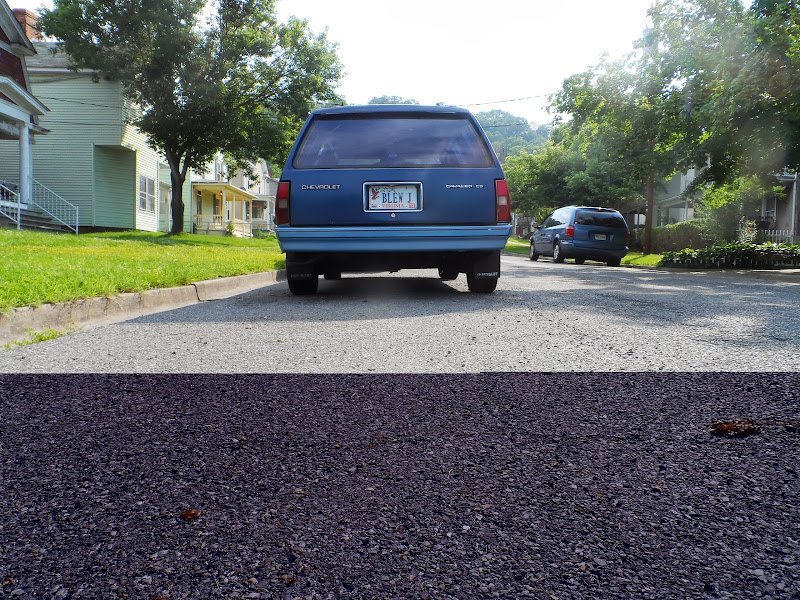

What about a shot of the back?
