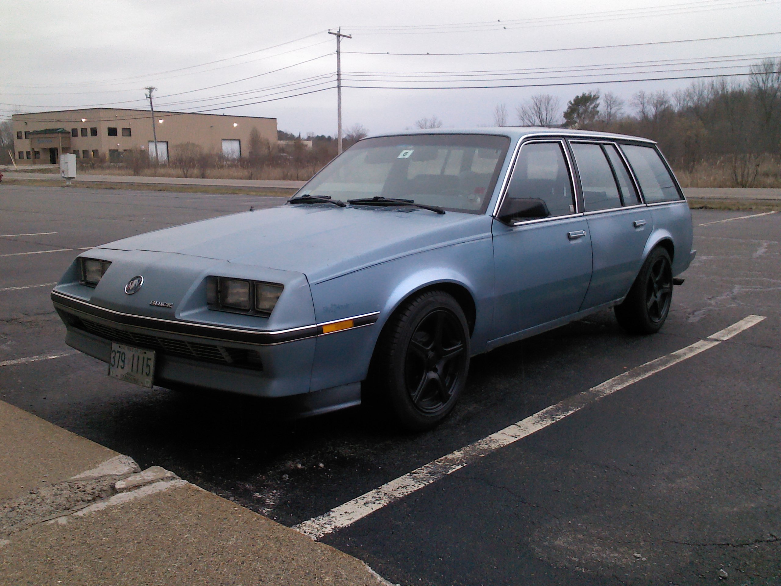

To the update. I love driving this thing despite the rather measly 85hp and all the updated parts really make it handle nice, but I'm worried about wearing out yet another set of tires with the steering issue, so it's been doing minimal duty lately. I've done new (junkyard, but very nice) control arms with poly bushings (ordered 2 sets for 2nd gen J and used both the smaller bushings) and new ball joints, Canuck lowering springs which improved the ride and looks immensely. Also tie rod ends, new o2, replaced the p/s fluid to see if it would help, Viper remote start, belts, hard wired GPS, VDO Tach (fits perfectly in a tomtom GPS mount for easy mounting!) and have been hosing everything underneath with eastwood rust wax stuff, it's pretty nice underneath and I am determined to not lose this one to rust. I like it too much and it's too rare. I'm also planning on having a shop replace the rocker panels very soon, the driver side is rather ugly, but other than that the rest of the car is in surprisingly good shape. That's it for now, many more plans in the works, but I need to get my rust and steering patched up .. runs great so that's all that's holding it back right now.
The wagon a few days ago.

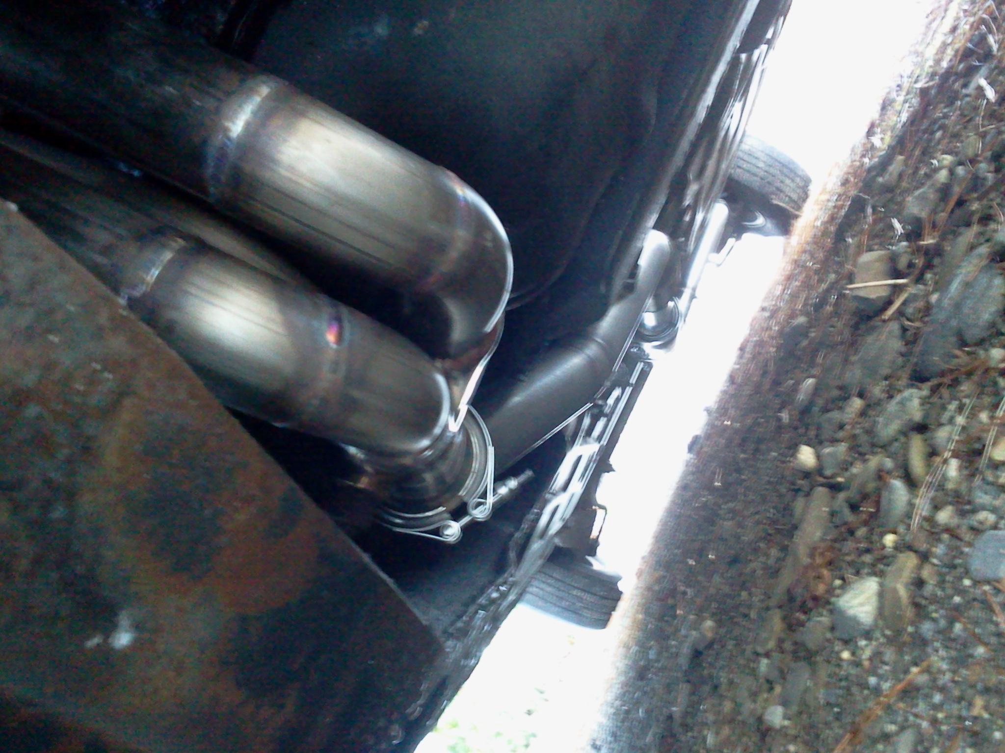

Now I'm in the process of swapping on my entire stainless exhaust from my (now-parts-car) two door. Turns out the 1.8 oil pan is different from the 2.0 (deeper and wider) which didn't leave enough space between the frame and pan for the big header (
like here), so I had to swap on the 2.0 and its windage tray. Thanks to Ron for his writeup on how to seal everything up. It's a little different because of the detached tray (more of a pain,) but the same principles apply.
