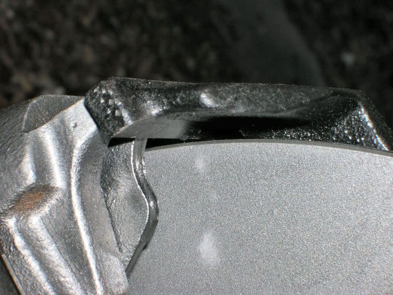

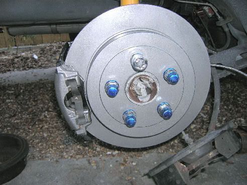

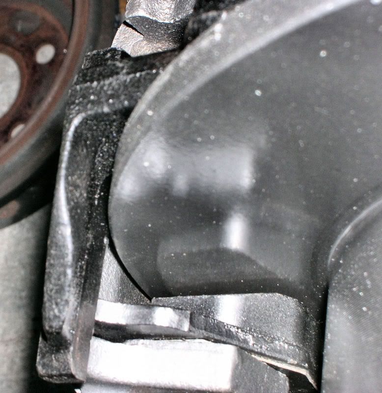

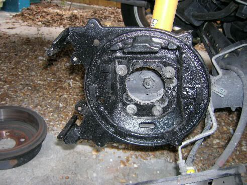

hers a pic of my set up with teh 10.6 rotor on a "14" bracket I had to do i little creative grinding to make it fit with out rubbing
the bracket by itself mounted
close ups of the space from rotor to bracket before machining, sorry i don't have any of the after, but all i really had to do was take teh square edge that was rubbing and grind it down a little of each side with same tool i used to grind down teh numbs on the rear twist beam.

eerrrrr ooops forgot to mention that those ARE NOT NEON BRACKETS . just use it as a reference as to how your may fit...can ya tell it been a long day?
