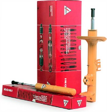

Koni sport (yellows)
Unless they come with springs wich I dont think they do...
If I want to lower the car with these, what springs should you get with them?
you can do any drop amount you want with those bad boys.
depends how low you wanna go. ...imma eibach fanboi, so i will recamend those
best choices are:
eibach sportlines will give you something like a 1.9 drop in the front, and a 2.3 or so in the back
[which levels out the car. making it look straight and level all the way around, instead of higher up, and goofy looking in the front.]
also this setup has about the best ride quality for the amount of drop tou get. and better handling than any other spring, caz yur lower.
other ok option [i got these on my car] the eibach pro-kit. gives the car an even 1.7 drop all the way around.
slightly less handling capability, and a little more sloppy than the sportlines. but a little smoother ride, because your
not as low to the ground.
so all in all, it depends what your gonna do with the car, how low you want it to look like,
if you have snow in the winter, and if you drive in the snow [wif you have it durring winter]
^^^^ ummmm, pro-kits better for handling my friend, you want your control arms horizontal with the road for best handling, which is what you get with pro-kit. And iirc last time i checked pro-kit was 1.25 all around.
either way, sport-line/pro-kit is a good way to go.....if it where me, i'd go with ground control coil-over sleeves on the yellows, that what i had and it was awesome.
Edited 1 time(s). Last edited Monday, November 09, 2009 2:39 AM
I've had yellows with Tein S-tech's, Road magnets, and now I'm on Ground controls with their " street" spring rate. If I were to do it all again, I'd say Tein S-tech's if your looking for some thing to give you a nice stance and still be somewhat comfortable for dd and some auto'x. If your not looking for a smooth dropped ride and can handle a little bumpy ness I'd go Ground controls before Roadmagnets simply because come winter you can lift the car with the coil overs.
But it all depends on what your looking for...I'd stay with my ground control's personally though. Did you check to see if anybody local to you has a similar setup that could take you for a spin in their car to give you a rough idea on what you might like? Oh and remeber your going to need your stock struts still so you can pirate some parts off them and gut the front struts for the inserts.
I run s.techs and koni yellow's. Current set up is in my reg, but to sum it up, the car rides better than stock over bumps and is surprisingly fun and stable in corners even with the dampers on full soft setting. Turn them up and the cornering gets better as long as you have flat surfaces.
I would assume the pro-kit will be similar, and the tein h.techs will lean more towards the "comfortable" side.
sportlines and b&g are quite firm so be prepared to turn up the damping to avoid "bounciness". You will have a harsh ride on some surfaces.
