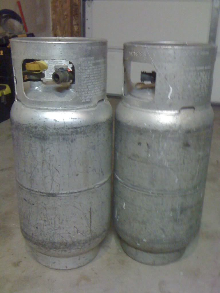

So I have some empty 33lb aluminum LP tanks laying around at work. The valves on the tanks are either shot or leaking so I snatched them up. I am in the process of re-working my bag setup and came across an idea.
I was hoping to use one of the tanks for my air system but, I have a few concerns.

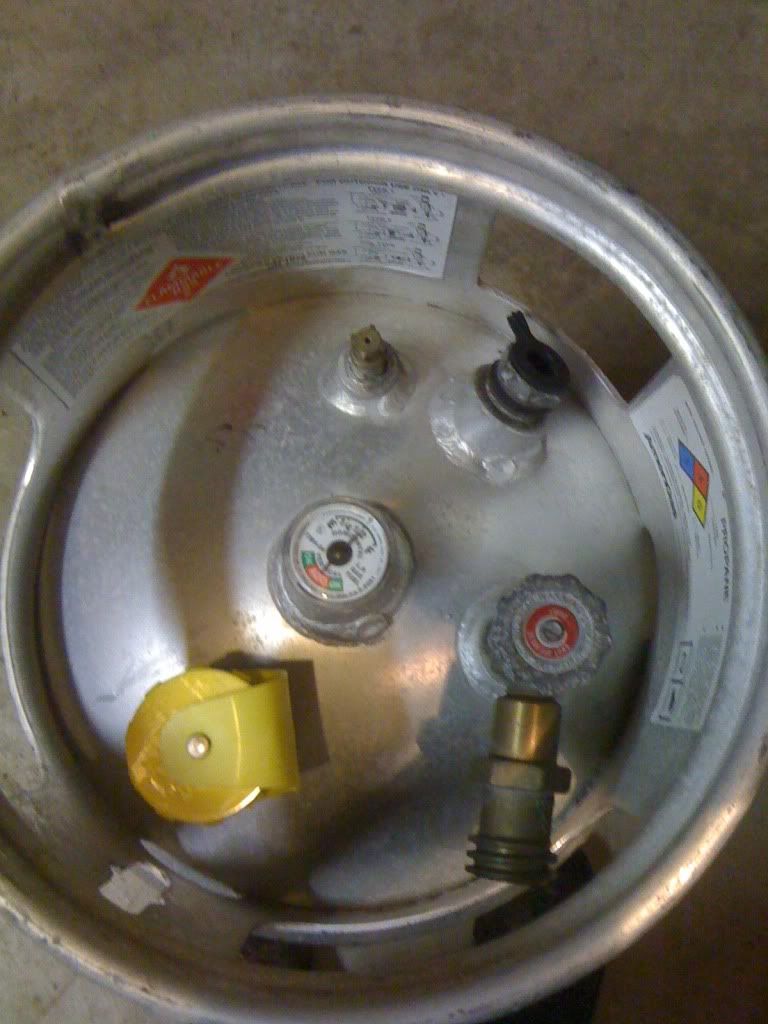

That is tank 1 with 6 holes.
This is tank 2 with only 5.
I do indeed have 2 tanks.

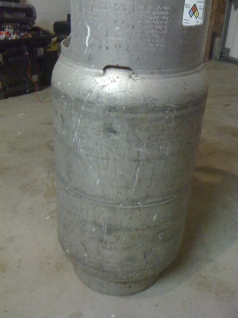

Being aluminum, would that suffice(be safe/structurally sound) for an air tank? or should it be steel?
Would it hold 200 psi of air? I have the standard easystreet air setup with a 200 off pressure switch.
I assume that the fittings on the tanks are merely held in with thread locker-or am I wrong?
I should just be able to pop those out and switch them for the fittings needed for the air equipment...right?

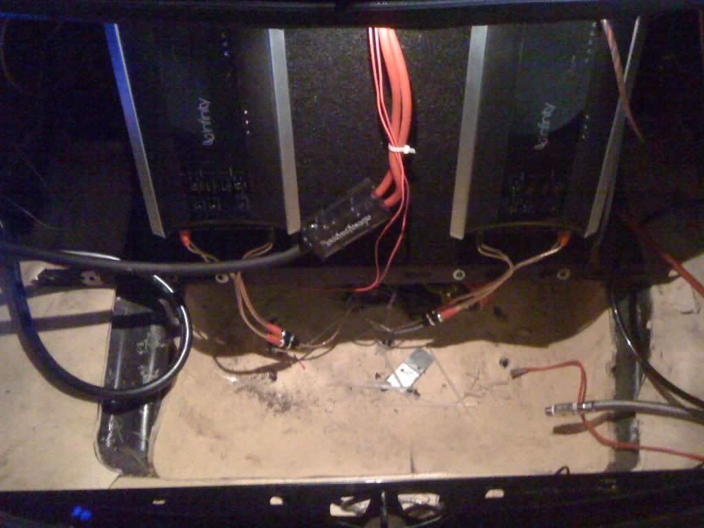

I plan on putting it here. It was a very snug test fit. It did fit. (That sub is NOT moving...in any direction...ever)
(The amps are for the mids and highs. They are mounted on a JL 13dub7-awaiting an amp

I had my old tank sunk where the spare was, all hidden by a false floor.
On a separate note how should I secure that box down. As of now I am using steel from a bed frame to keep the back from falling into the spare wheel well.(Bed frame steel is pretty thick. It holds up big fat fatties for years on end so, I'm not scared.)

I was able to borrow wrenches and with the help of my father in-law we were able to take the hardware out of the tank. I ended up dismantling the one with 5 holes because all of the holes were threaded.
I have yet to find out if this will be a suitable tank for air. It holds 33lbs of liquid propane which is pressurized so I am thinking it shouldn't be a problem. I am hopeful.
I don't have any pics from tonight. I will update again tomorrow with what I have found out as well as pictures.
Find out what the max pressure the tank is rated at. More than likely it'll be fine holding ~150psi of air.
I'm sure theres some DOT numbers on those tanks, just look up the specs online.

I fill those propane tanks daily at my job. The reading on the gauge coming off the pump varies between 200 and 250 psi. Those are MORE than suitable to hold air. Just be sure to use a good Teflon thread sealant went screwing in the valves and/or plugs on the tank.
