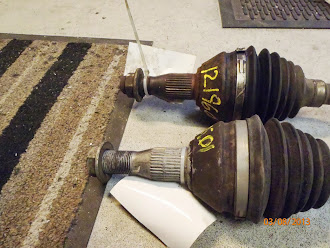

Picked up a pair of used axles for the appropriate wheel bearing I had - W Body
Cut and cleaned up with 3/16" left as a shoulder
Installed into bearing hub
