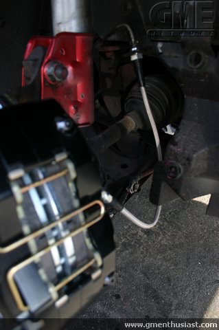

In the meantime, I had the passenger side assembled, and this evening I decided to install one of the stainless steel flexlines on that side. Unfortunately, the SS flexlines that come in the kit for the cavalier/sunfire are too long. Allow me to explain...
Take a look at this pic from the Wilwood pictorial install guide on Jbody.org:
Notice how the line runs underneath the edge of the plastic fenderliner - when one rotates the steering wheel to full right lock, the brake line will catch on the edge of the fenderliner. This can be remedied by trimming the fenderliner. However, at full left lock, the line will just about rub against the lower control arm.. To prevent this from happening, the line would need to be shortened by approximately 4". I've reached the point of frustration where I'd love to beat the gentleman who assembled this kit, and in turn, I'd like to drop one of my rotors on the head of the Wilwood engineer that designed this kit.
Aside from venting, I was wondering if anyone else on this board has had the same problems? Considering the quality of the individual Wilwood components, I simply cannot fathom how such small oversights could have been made in the assembly/design of this brake kit.

Thats probably because the line should be run through a cable clamp (I hope you know what I'm talking about, I can't think of the exact name right now....) attached to the strut, similar to the factory line. Or at least every kit I've seen has one. The picture you have is the lazy way out.
With respect to a cable clamp, I do know what you are talking about. However, the stock brake line on an 04 cavalier goes directly from the hardline to the caliper itself. There is no clamp in-between.
In any case, if a clamp was indeed necessary to properly secure the line, Wilwood should have thought of that. Call me crazy, but I don't think that I'm asking too much.
In any case, I probably bring my line to a hydraulic shop to have them shortened by 3.5". This whole project has me hella pissed-off...
Arrgh...

I had the same problem, caught it only a few hours after install another few miles and i would have had a real problem.
ever hear of zip ties?
Fixed the problem in less than 5 minutes
Your supposed to make a loop in the brake line so you have free travel in the suspension without pinching the brake lines.
Like this...

My Baer setup has the lines rubbing against the control arm as well. I just added some loom to them to prevent them from wearing through.
Maybe I'll look into fastening them somehow... never put much more thought into it once I had the issue taken care of.

I have no idea how you got that to work, but at full left lock, the loop in the top of the line will rub against the fenderliner and the inside edge of the tire.
No dice...

I called Wilwood and mentioned the problems I am having (clearance issues, etc). The SS flexlines in the Cavalier/Sunfire kit are approximately 19" long. When I spoke to a technical sales representative, he asked me to measure the length of the original rubber brake line -- it is approximately 11" long. When I mentioned this, he said, "You've got too much line down there (refering to the lines in the Wilwood kit). Then he said, "I'm going to send you a set of 14" lines." In short, he is sending me a set of 14" lines with all of the necessary adapters. Thanks Wilwood...
The 14" SS flexlines should work much better -- once I install them, I'll post the results.

john317 wrote:Your supposed to make a loop in the brake line so you have free travel in the suspension without pinching the brake lines.
Like this...
if that is the pic from karo's cav , i can show you the brake lines , and the damage to them
the line rubbed the tire , and wore through outer cover , and 1 line was almost pinched
in the directions i got from wilwood the lines ran just like the pic with them looped down
ill double check mine this weekend , but last time i looked everything looked good
Really... Karo has never said anything about it to me.
I've been running mine like that for about 18,000 mi. but the loop is a little lower AND it's not a Wilwood kit. Just a Wilwood caliper.
