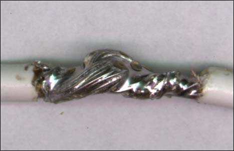

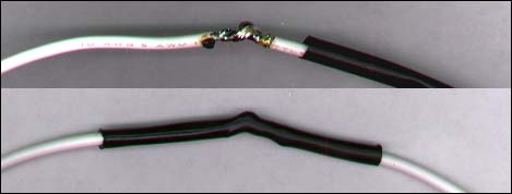

Just buy cheap crimpers and crimp it.  or solder it and use some heat shrink...
IF you solder the wire, hook both wires into a fishhook shape, then twist them back around themselves.

http://www.ehow.com/how_376_solder-wires.html
