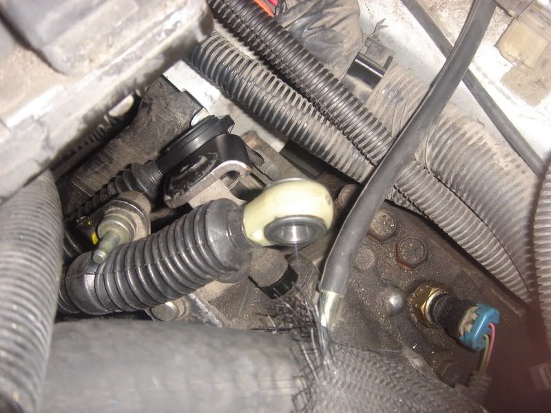

here are a couple of pics always easier with pics
this is the new one that wont go on the tranny
and here is the old one, they look way diff.

Umm....a '96 eh, you've got an isuzu transmission and you have the cables for a Getrag transmission (2000+)...totally different. I dont think your going to get it to work at all. Take it back and get the proper cables.

the connection in the top pic is the one not fitting, it will just not snap down on the prong here is better pic with the prong behind it
the prong just hits the back of the hole and wont snap on, i was thinking it is from a 95 vin and the dealership said that it went from 96-99 and i have a 96 so could i just change the prong it is suppose to go onto cause it is just bolted on...one more thing, the big round thing back on the cable a bit that slide down in the slot to hold the cable still, this cable wont go down in that either, no problem with any of the other 3 end at all.
