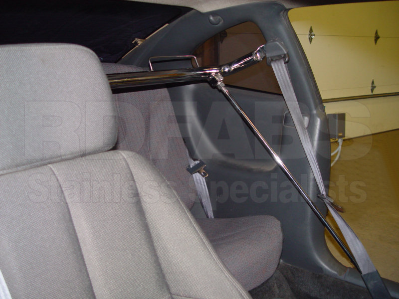

We designed this on Chris's 2000 Sunfire originally for Joe ( Eazy ) just as a basic stiffening bar that he was going to mount his seat belts to. Now he has an 03 and it worked just fine in his car. Then redesigned the next one for ruen off Sparco's design so that it also has support for the bar to anchor to the lower seat belt bolts. The only updates added were the stoppers on the bar to hold the belts in place if you wanted to add them, and the lower support bars. But we all know that anchoring 4-pt racing harnesses without a roll cage built into the car is a bad idea if you some how roll the car because it locks you into the position you are in. If the roof collapses on you, your pretty much well dead. We list it as a "stiffening bar" yes for legal reasons and supply that in writing with its intended purpose when someone orders one of these. It mounts up using the same upper bolt that the stock seat belt requires but behind the stock seat belt swivel thing there located on the B-pillar. Is that how you have it mounted in there or did you totally remove your stock seat belts? There was zero play in this when we fully had it installed and tightened in Chris's car. It mounted up fine in my sedan, but it was by far too short since the sedans seats sit further back past the b-pillar. Now this issue has been discovered where they are only going to work on the 95-02 models until we can get one of the new 03+ Sunfire and Cavs into the shop to confirm this fully. I'm going to inform Ryan of this right now and get this info on the site changed around until we can get this fix or design a new bar for you latter 3rd gens.
00 Sunfire interrior
Eazy's 2003 cav
See how its mounted behind the upper belt swivel thing?
Ryan can you post up some pics of your interior of the 04 so we can see how much of a difference there is or what is being crushed? I PM'd Eazy to see if i could get more pics than that one i just stumbled upon trying to figure out whats going wrong here. I just called Chris as well to inform him that there may be a possible issue.

If i recall correctly when we made the first one off of chris's sunfire and i was in the shop for the final install for fitment purposes before it went out to joe a year ago, there was none of that foam/ sound deadening material behind his. Where the bolt attaches to the b-pillar the metal mounting tab was actually metal/width of plasitc b-pillar/ metal behind that bolt. His cover did not bow or anything because there was very little clearance behind the cover to the metal b-pillar structure. There has obviously been some interior upgrades since his Sunfire's b-pillar covers to yours. It was literally extremely snug to where it would have some stiffening support, i remember yanking firmly on the sucker. To our knowledge, all 3rd gen J-body's were the same interior wise for that portion of the vehicle....
I am no where near my car or the shop to verify this for you right now since i am about 75 miles from the shop at college. I have called chris and informed ryan the shop owner of this issue and am waiting for chris to jump online to chime in here aswell. I'm sorry to hear that your extremely upset with the bar... I hate for anyone to have to be the first to find out that something doesn't fit correctly due to changes in years that wasn't known at the time of fabrication. We are going to figure out how different they are and more than likely have to design a new bar for the cars with this clearance issue.

To date, we've sold quite a few of these but I couldn't tell you the (newest model year) car it's been installed on. I know for a fact it fit my 2000, Eazy's, Phewes and Cody's cars. We've never had a complaint about this bar and if/when something we sell to a customer doesn't fit or work, we remedy the situation immediately. The fact that you purchased this bar second-hand is a new situation for us and I can't say right now how we're going to handle it. I'm not sure why you didn't just e-mail or call us to remedy this, though.
As has been stated numerous times in this post, the bar is what it is. It looks strikingly similar to the Sparco harness bar, doesn't it? IT DOES NOT MATTER IF THE BAR TOUCHES THE METAL ON YOUR B-PILLARS. Let's just say someones used this bar for a harness bar...the force exerted on the bar in an extreme braking situation would be forward and down. In other words, in all directions that we made SURE this bar was 100% sturdy. The bar would also be at the correct angle for such use--it's within specs necessary for ESTA dragway.
