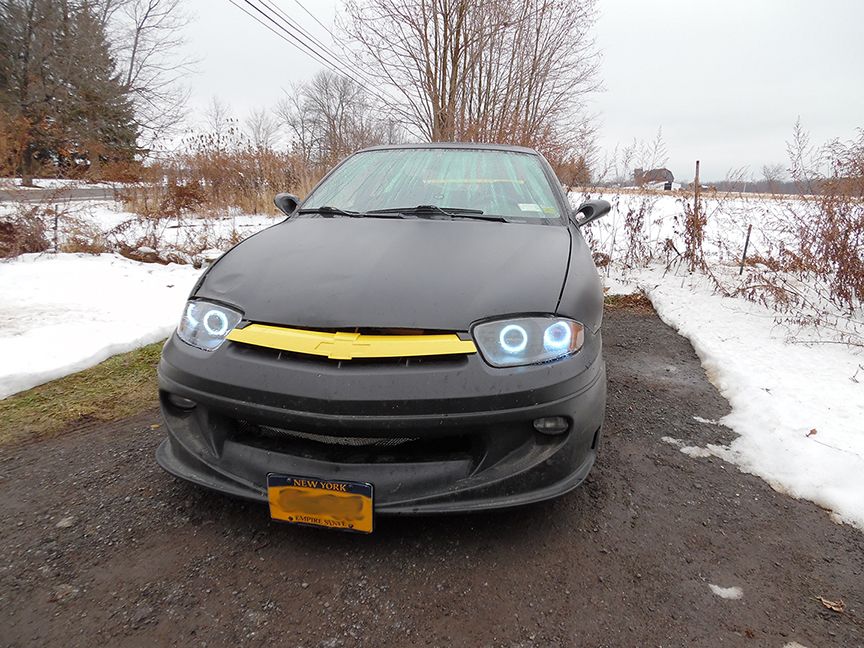

I bought a new set of projector headlights, wasn't happy with the CCFL Halos that came pre-installed so I decided to do something about it. Bought a couple sets of the RGB LED Halos that TRS sells and tore everything apart.
I'm pretty happy with the turn out, color range is decent. I bench tested them with a PWM controller and was able to get a much wider and more refined color pallet than what their included control module has. My camera is terrible at night so the pictures I took at night were garbage, might try taking some with my wifes camera when she gets home tonight, hers is much better.

This has been on since August 2013. It started as a try out for flat black full paint then turned into a durability/longevity test as people were asking about it. I think it's coming off in the spring for actual paint. I have some pictures of it around somewhere I think, I'll take a couple more if I can't find them tomorrow, until then I'll leave you with these.

Yellow, here are 2 more shots of the dip, excuse the dirty.....winter. I was impressed with it's durability, that front right is where I tagged a deer and there was no damage to the dip from the impact directly.

Thanks! That's impressive, I really want to do this to my car. Did you use their special sprayer? I used 3-4 cans just on my hood and it still didn't turn out the way I would have liked.
"In Oldskool we trust"
No those are HID's from TRS, XB35 35watt HID Kit. The halogens it came with were junk.
I used my HVLP gun to spray. 4 coats is enough, I did 6 on my hood and 4 on my front bumper and there was only a marginal difference in durability. 6 coats on the good was a touch under 1gal.
