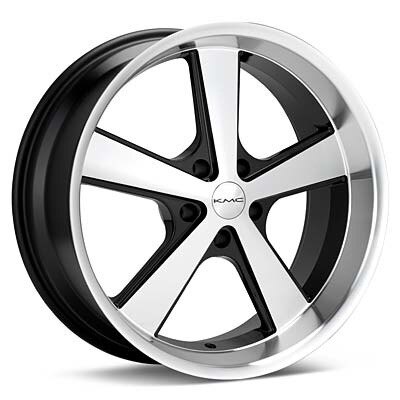

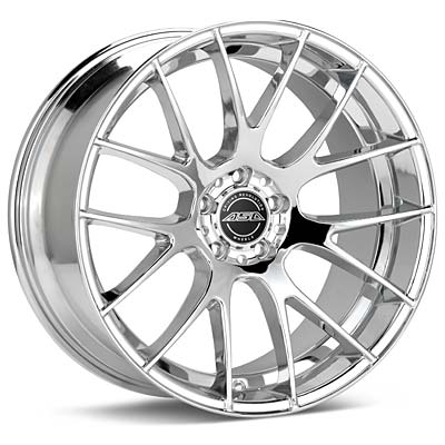

Future plans are a Protege Garage turbo, which is a stock turbo that's ported & polished and they change the center section out for a higher-flowing but quicker-spooling setup. So I can run less boost and make the same power, but with less lag and more top-end pull. That's 3 years away, though. Maybe heavy-duty motor mounts if I can find some that don't rattle the fillings out of your teeth. I also want to lower it with either H&R or Vogtland springs (about a 2" drop) and add some 20's to it. I have a set of Yokohama Parada Spec X 255/45-20's ordered from Tire Rack, but they're on backorder for another month or so. I have 3 wheel styles I'm trying to decide on:
ASA GT5:
Sport Edition KV5:
KMC Nova:
I like all three, there's one I like a lot more than the others but it's a fair amount more expensive, too. I dunno, let me know what you think.

At least everyone else is on the same page as I am. I really like the first wheels, but not in chrome, and they're not available in silver. Sooo, that means the Nova's are gonna be it.
