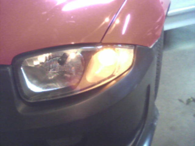

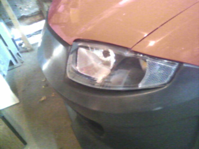

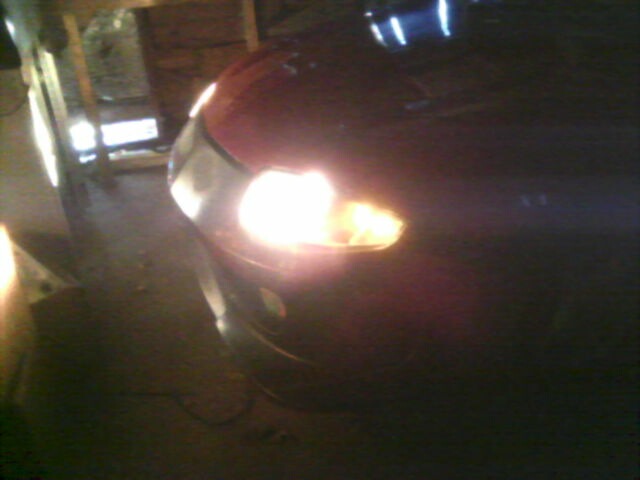

well, as some of you know I'm doing a complete write up on clearing the headlights. I know it's been done before, but I'm adding pictures for every step so even the dimmest bulb can do it right lol.
I got so many e-mails about the clear lens that I decided to make some... what do you think?

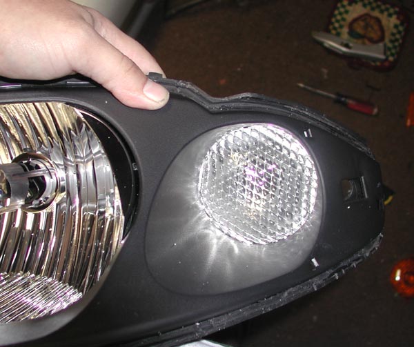

everyone knows the old look
and the new one.
any opinions?

looks good, where did you get the clear lens part??

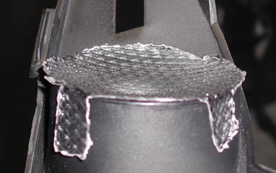

I had to make it lol, I'm working on the side one now, I'll post pics as I get them done

i'd like to see a write up on how to clear them...not just remove them and replace the deflector
made em, huh? looks good. id like to read the write-up about making the clear pieces. when you finish the side one, it will look hot

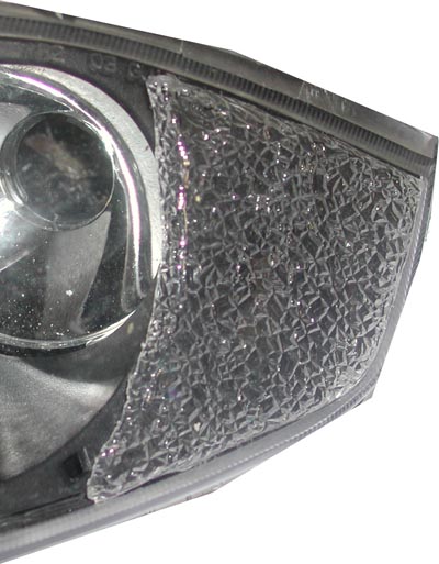

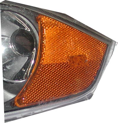

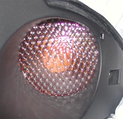

ok, side marker...old one.
and the new ones, you might not be able to tell but the second one is a bit less clear.
these are just for fitment so the edges are rough and not perfect fits. but you get the idea.

as far as I can tell the plastic on the markers is orange, not just a coating.

Grimor wrote:as far as I can tell the plastic on the markers is orange, not just a coating.
Your right, that note above will not work. The circle ones look better than the outside reflector tho.

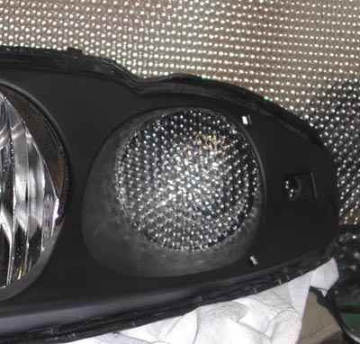

yeah, I think I'm going to use the same diamond pattern on the sides, I'm just about done with the how-to then I'll work on a more finished looking reflector.

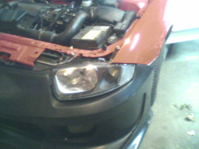

if anyone is wondering what plastic I've been using....
The best is the diamond pattern, it's fairly thick, easy to work with, and stays clear. It's the light panels you use for ceiling flourecent lighting. Use Acrylic..
I also tried to use Styrene, but it's a bit thinner (might be from the pattern) and seems more brittle.

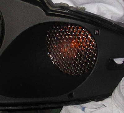

how about clear over orange? - I didn't liek it either lol

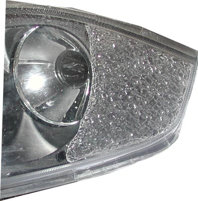

I found the easiest way to hold the lens in is not to use the stock mounting holes, but to put it on the middle housing.
using the tabs with this stuf is just a PITA and you won't notice the difference once the housing is together, and less chance of a gap.
mounted to teh stock spot, you can see a gap

now thats an 03+ headlight I dont hate.....
