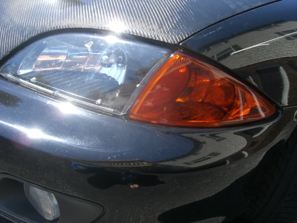

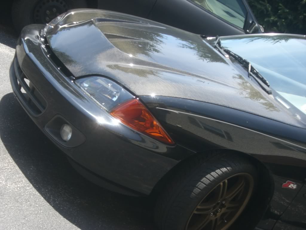

thanks a lot guys. heres what i did... wet sanded w/ 1500. used PPG plastic adhesion promoter, and sprayed with amber tinted PPG clear coat. i work in a body shop so i just had my painter tint some clear for me. they look amazing.

Re: how do i paint my corners amber?
Monday, June 25, 2007 3:13 PM
very nice man
Monday, June 25, 2007 5:17 PM
clean, very clean
